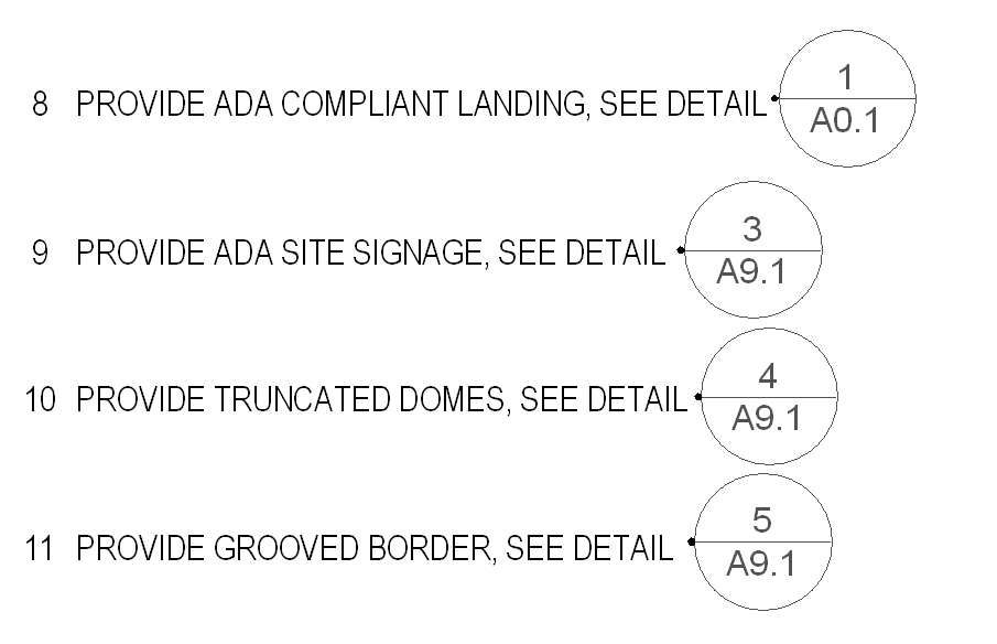

I would like to create a detail bubble without the adjoining cut line. But cannot see a way to do this. I can edit the bubble type but can't get rid of the callout box or cutlines. This is not a separate visibility either so can't turn it off and leave the bubble on. I get that this is a system family and so is somewhat limited.
This coulb be a callout or a detail section so that when we reference a detail we can place a bubble next to the note.
IE For blah blah blah, see detail (insert bubble). See attached image.
For now the only way I am able to do this is to pull back the callout grips to a dot next to the "head". It works but would love to have the bubble without the associated callout box or cutline...
I am a longtime revit users and am used to doing a few workarounds but this one seems like it should be simple to do and very convenient.
Also would be "wonderful" to be able to place above said bubbles on sheets. As it is I create a dummy drafting view and place it under my notes with no view title.

I tried for the longest time to do the exact same thing and ended up doing what you have shown in your attached image. Sorry I couldn't help..
