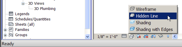

Hello everyone.  I am having an issue in my project where I can't get any of my existing piping to show as a dashed/hidden line when it is behind another pipe.  The new piping shows as dashed when it is behind but not the existing.  Any suggestions would be greatly appreciated.  Thanks so much.   Also i'm having another issue where i can see objects through my boiler.  For example I can see the staircase behind the boiler through the boiler.  Is there any settings I can change so that the boiler is not shown as see thru.  Thanks so much everyone in advance for your responses.

Hmm, the simplest thing to check first is... whether you have your display set to Hidden Line as shown below.  Without hidden line, your boiler will be transparent and the dashed lines will not display on items below other items.
