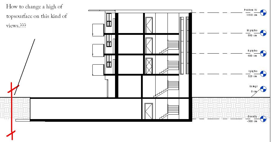

HELLO, I am prepering a project to my school, and I am heaving a problem with hight of topography. I made a screenshoot, to show what kind of problem I.ve got. Meaby you will be able to help me. THX

In 2010, from a plan view, pick the massing and site tab, then the lower right diagonal arrow - setting is the elevation of the poche base.
