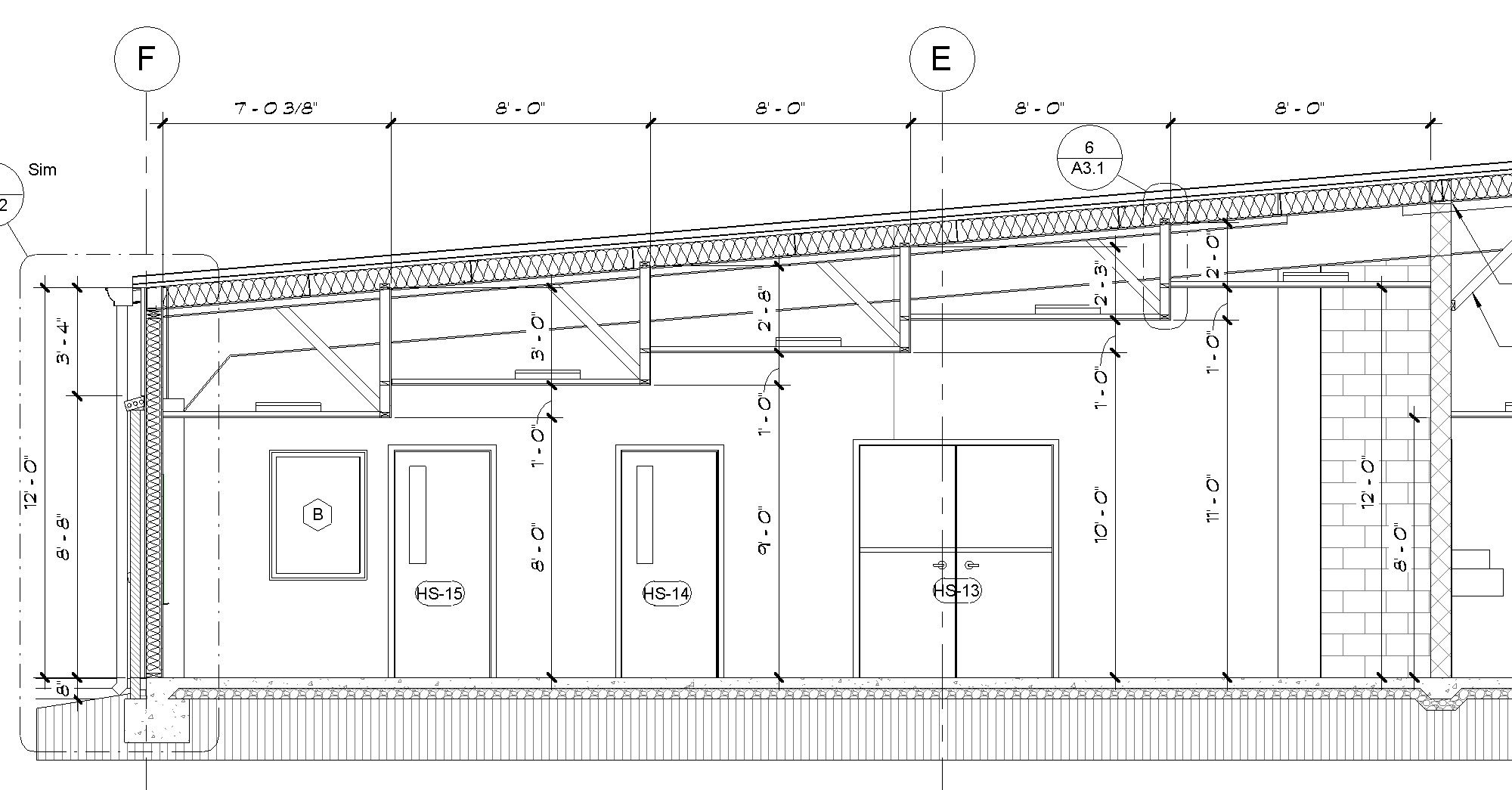

I am using a calculated formula for "Average Ceiling Height" in my room schedule by dividing the volume by the area.  In this band room, we have a stepped ceiling with furr down walls at each step.  These walls are designated to be room bounding but they don't in this ceiling location.  I tried using a line separation but that is not available in section.  Any suggestions?

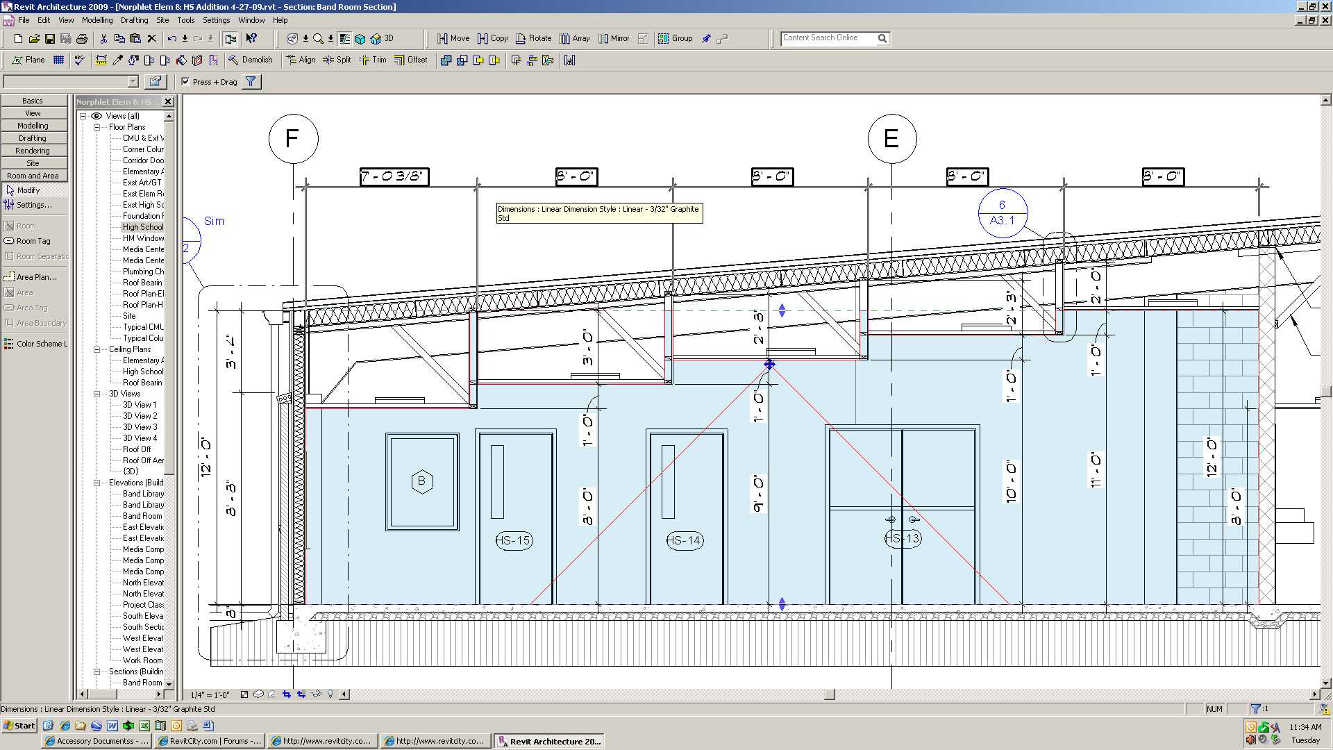

Here is the print screen view that shows the room boundary in blue.  The jpeg export didn't pick this up.

I think room bounding walls have to intersect the floor the room is on.  You will have to add room boundry lines.

Are room boundary lines available in section?
