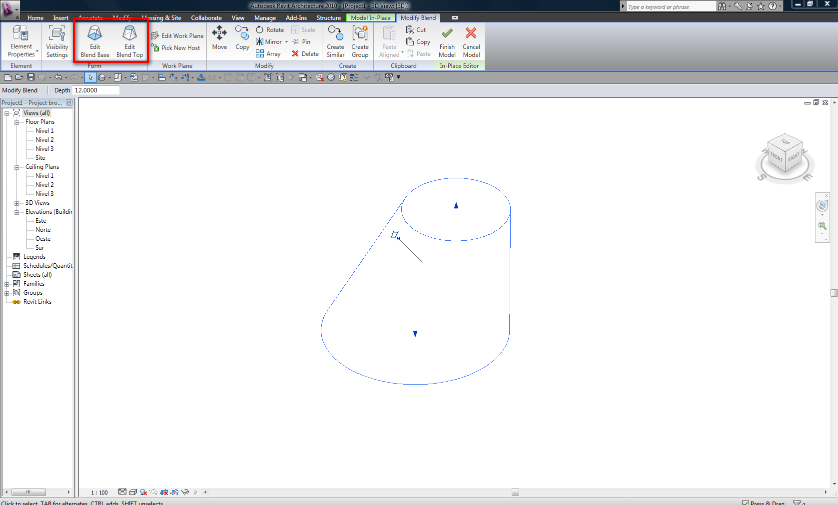

Ok I'm not sure my headline is correct but I don't know how to explain it in 2 words.
So I want to make a truncated cone shaped building, with the upper circle's center (which is the roof) in a slightly different position than the lower one. All I've managed to do by now is to.. eum.. make a cylindrical curtain wall. Thanks in advance for your help.

I'll sweep blend tool for this.

Use the Solid BLEND for this (not sweep blend)......

Erland is correct. I meant to say Solid Blend not solid swept blend.
