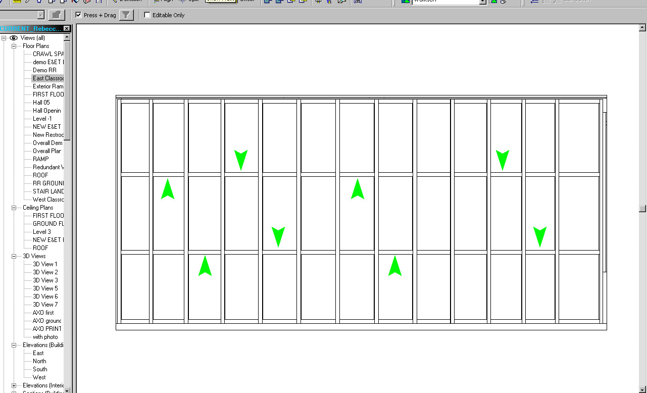

I have an interior curtainwall that is curved (faceted) in 2' sections.  I need to have horizonal members at different heights in each 2' panel sections (see attached picture).  Is there any way to do this?

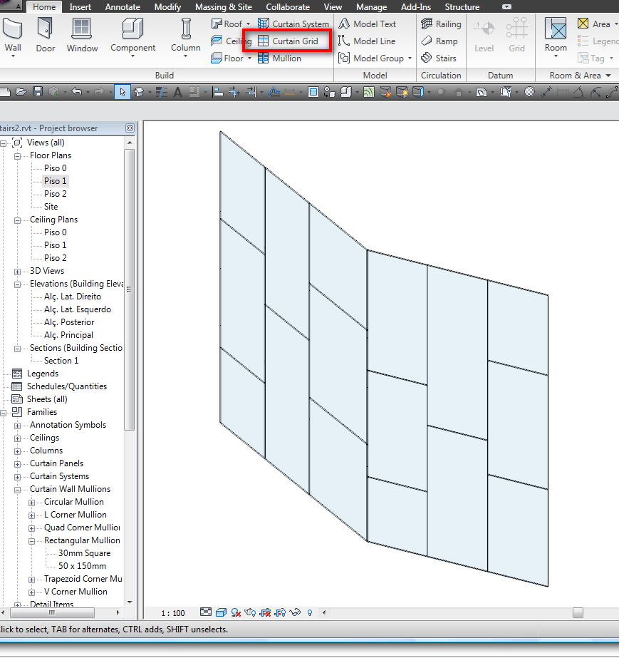

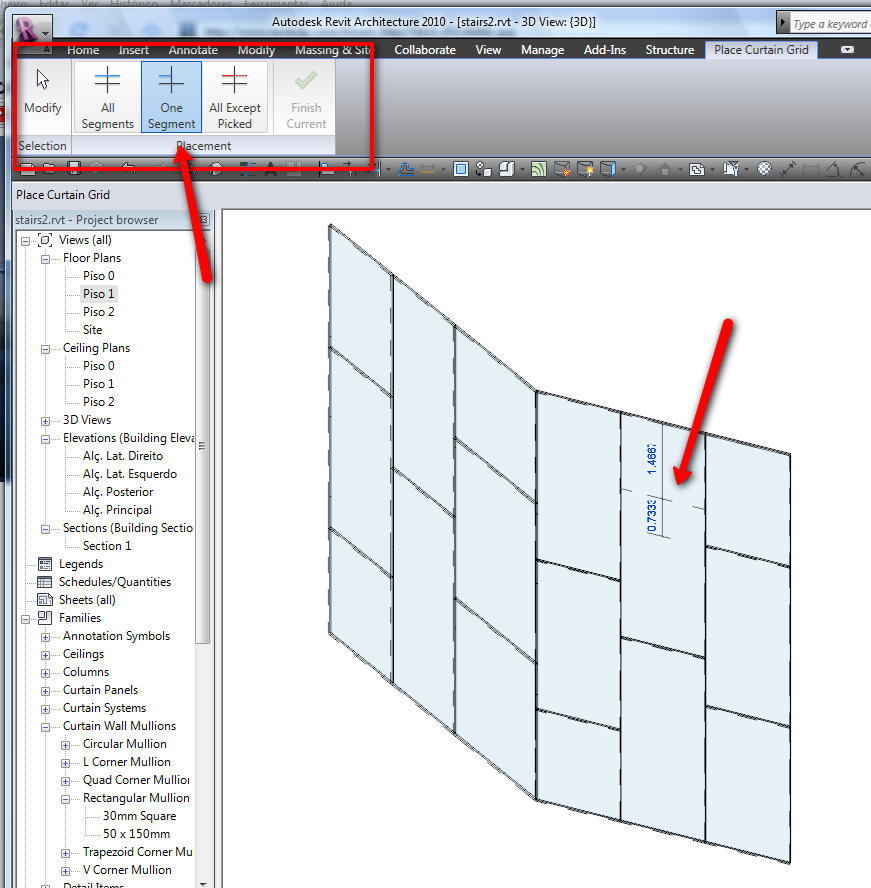

Very easy, after you create your "Curtain Wall" you have the "Curtain Grid" tool to divide the panels like you want, look the images attached.... Use the "One Segment" to create that...

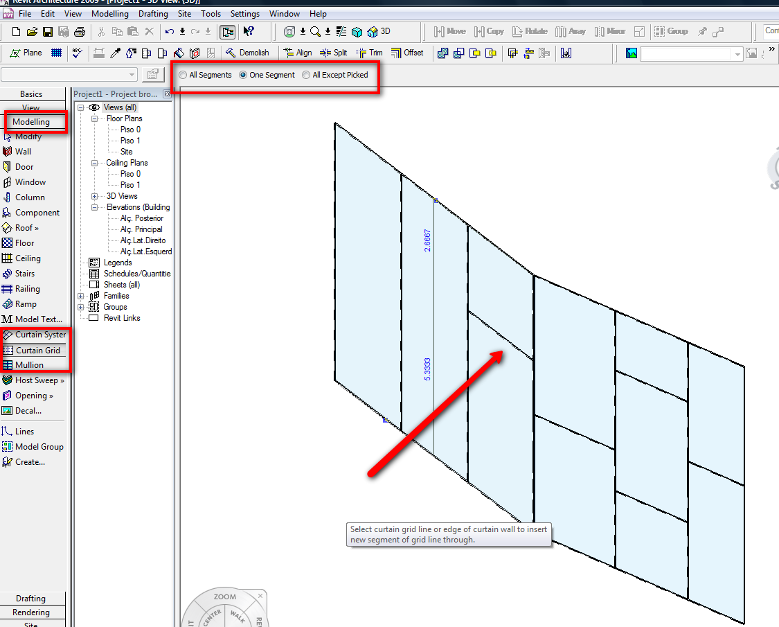

any tips for 2009?  I don't see the "curtain grid" tool.  I can click on the existing horizonal grid and select the "add or remove segment" but so far can only figure out how to delete a segment, not add or move one!
i have 2010, but had already started this project in 2009 and am in the CD phase and didn't want to switch over... if I can avoid it!

Do you need more?

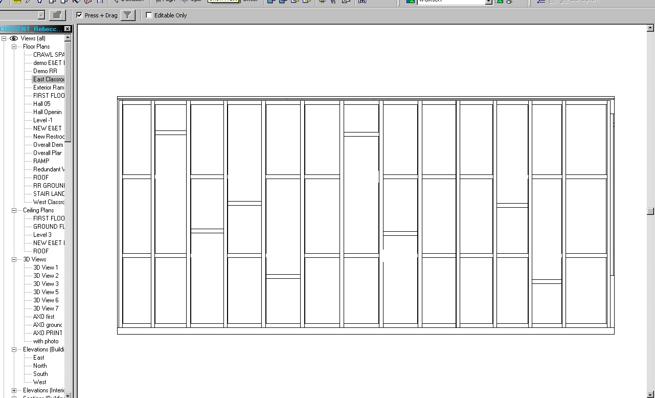

essentially, what I need to do is outlined in the two attached images.

AHA!!!
thanks so much for your help!
