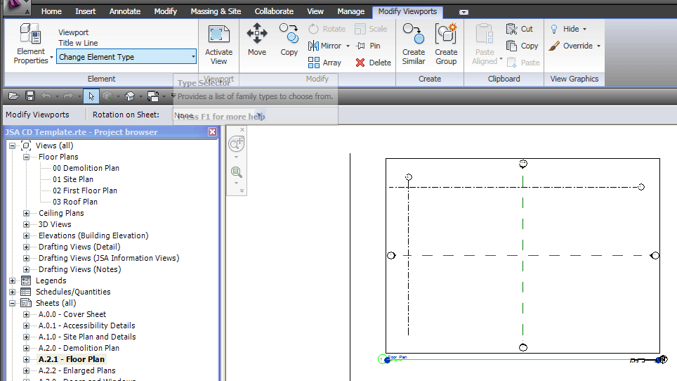

I have two viewport questions:
First, my list of viewports shows one that I would like to delete. How can I do so? When I look at purge all unused, I do not see it listed, however, that particular view title type is nowhere in my template.
Question two is, how can I set a default view title to show up as I drag a viewport on to a sheet? Presently no view title is displayed automatically when I drag a view on to a sheet.

Actually, the term is clearly in Revit in fact it is a system family. When you select the view to edit its properties, it shows as a system family called viewport.
I don't think you are understanding my questions though...
When I select a view and look at my "Change Element Options" selections, there is one that I don't use and want to get rid of it. How can I do that?
Secondly, when I place a view on a new sheet, presently no view title shows up. I have to select the view (viewport) and change the properties to have a view title placed. How can I set a default such that a view title comes along with the view?

Actually it says, "Change Element Type" not Selection. My bad. (See image attached)
What I have in this image is the view title that I want, but by default no view title is placed even after I place a view, and chage the element type to my "Title w Line" view title. If I grab anothe view and place it on the sheet, no view title comes with it.
Additionally, there is one viewport element within my pulldown list under "Change Element Type" that I want to delete. Any clue how to do that?
Thanks

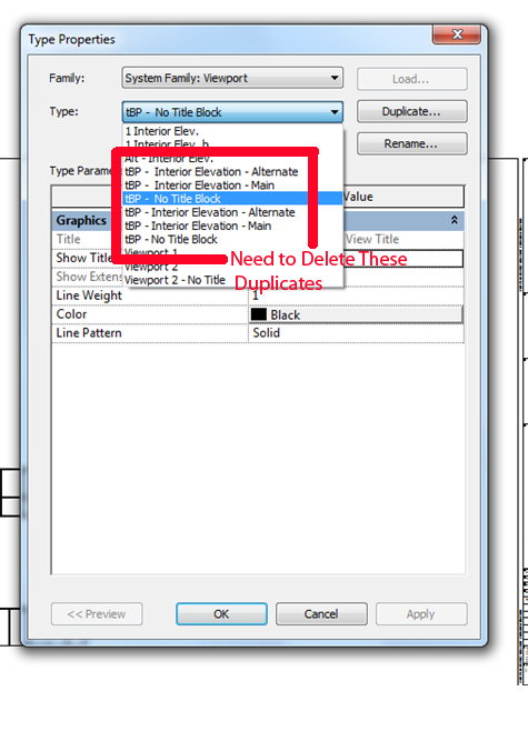

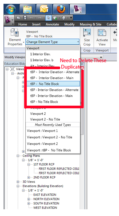

I had the same problem when importing from other projects. "Viewport 1" kept appearing out of nowhere.
 Here's how to fix it:
Select any viewport.
Change it to the viewport type you want to erase.
Type "SA" (Select All) You have now selected all instances of the bad viewport.
Change the type to a viewport you like.
 Purge Unused. The "bad" viewport will now show up.

it purges because it is an unused family.  in the project browser if you just select annotation symbols under familiesv and scroll down to view titles and delete the one you do not want.  it will not be called viewport in the browser.  you need to to delete the family view title that you do not want to show in your viewport.  a viewport is not a family but the title line is and that what wwhub is trying to explain.
