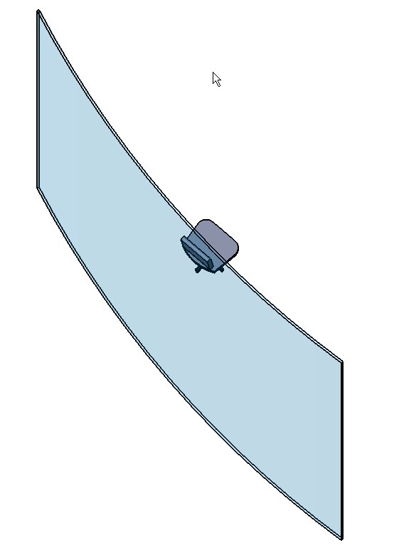

Someone knows how to make a curved curtain wall without vertical subdivisions (or without subdivisions at all)??
My graphics card seems to not allow it ... (nvidia quadro fx)
Has someone a tip? please it's urgent ...
If it isn't posible; has someone a tip in order to make invisible the vertical subdivision borders?

P.S: Making a simple wall with glass material isn't possible aswell ...
As I posted in this trhread:
Tue, Jan 12, 2010 at 3:14:01 PM | Glass wall (not curtain wall) problem with nvidia quadro fx graphics card
I'm using Revit Architecture 2009
Thu, Jan 14, 2010 at 7:21:22 AM | Curved curtain wall without vertical subdivisions?
Here is a curved glass wall made in 09.  If you use a single material in a wall, it must be assigned to the core layer, it can not be a finish.
Obviously, curtainwalls have straight mullions.  If you want anything else, use in-place sweeps or special families that you create.

Ok so I have to make a family.
Thanks!
Note: The weird thing is, that making a curved curtain wall without any divisions was possible we a geforce card. I just don't understand why it isn't with a quadro card ...
