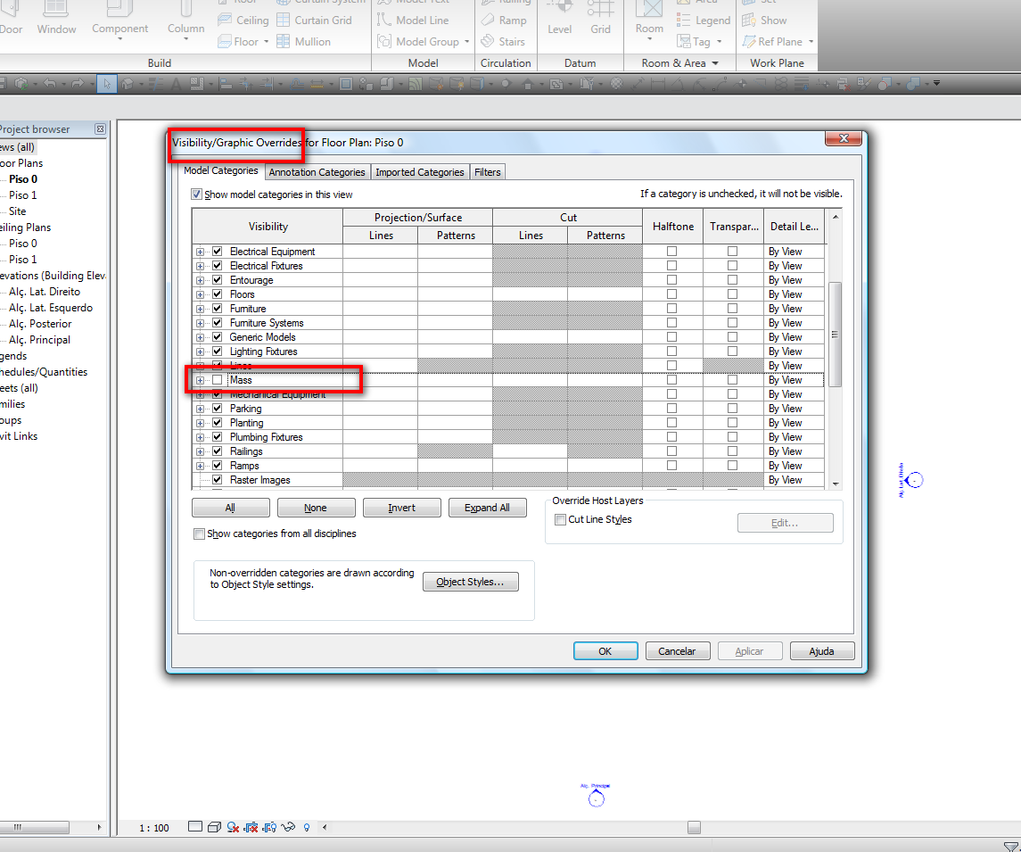

Did you try to turn ON the "Mass" in VG?

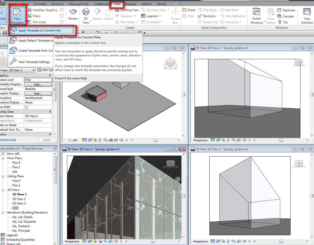

This is not true.  Mass being on or off is simply a VG setting for any view just like other elements.  Learn to use view templates to control what is on or off in your views ... including mass.

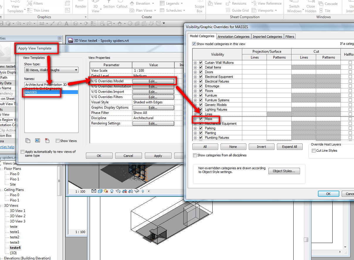

If you create in each 3D view the same View template and turn ON the "Mass" in VG, every time you enter in that project the masses stil visible... try it...
