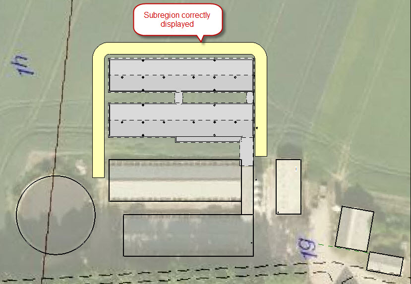

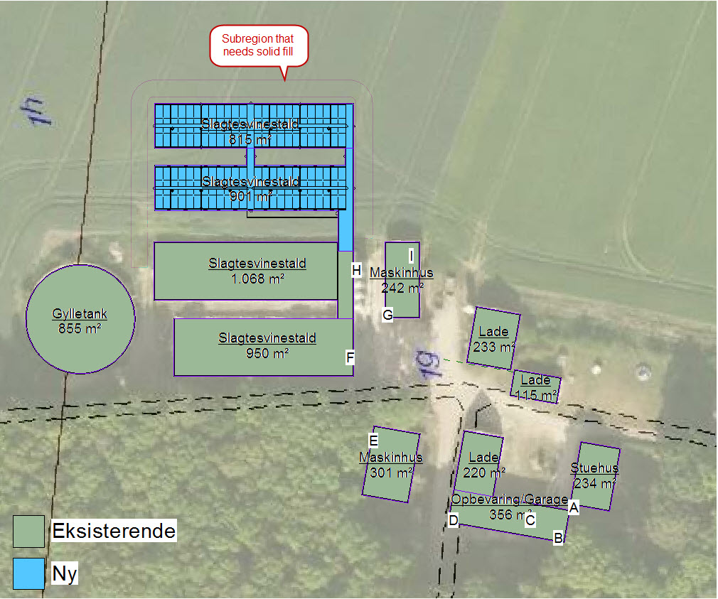

I have an area plan where i need to show a subregion (road) with a solid fill. I can only see the contours of the subregion and no solid fill although this is correctly displayed on a normal plan. On both plans i also have an arial photo. See attached images.
I've tried to compare visibilty settings in VV and VP - all the same. Checked Graphics Styles. Turned off color schemes. Tried without foto.

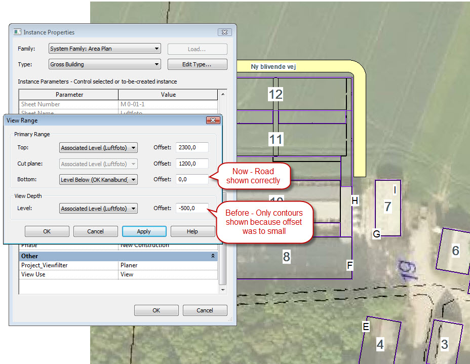

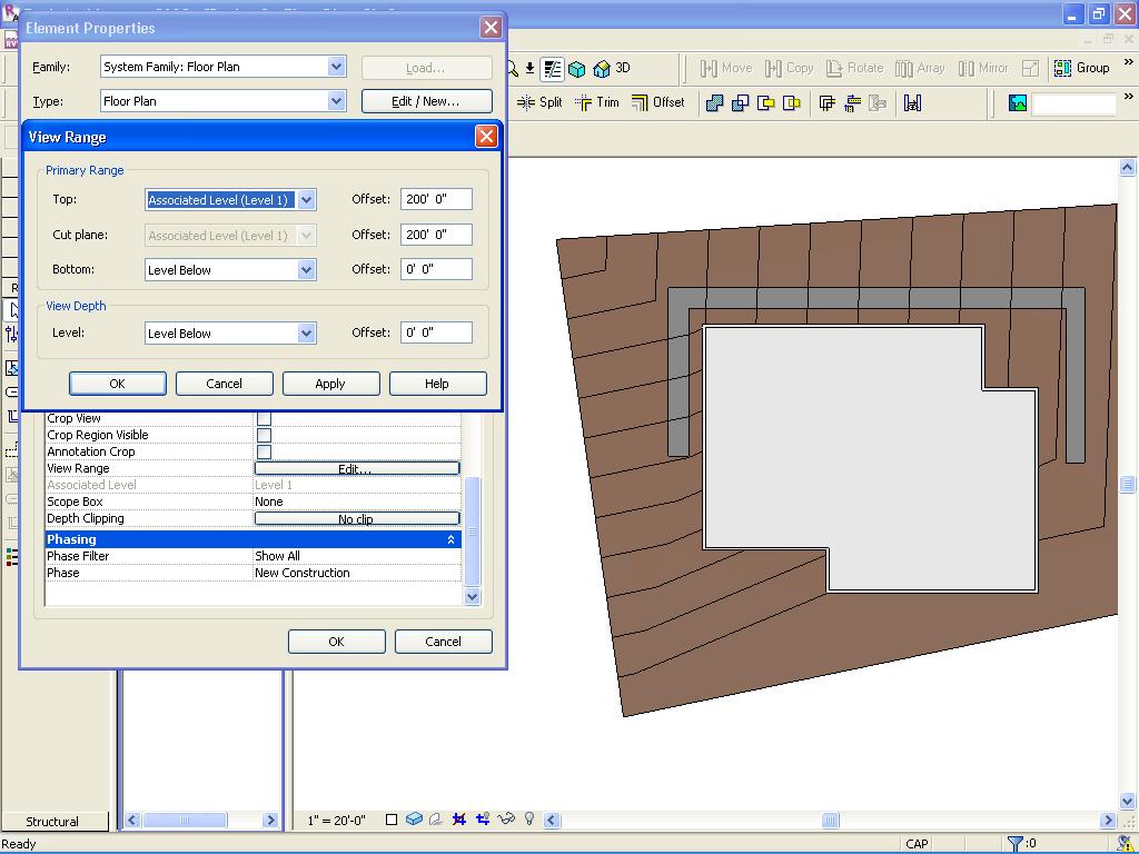

First of all, if i m clear, the area plan you are talking about is the Site plan actually and you are not able to see the "Solid fill" in Site plan..please clear me if i m wrong...Then you have to adjust only the View range of Site ("area"Winking plan.. Check out the attachment..
If you are creating a Area plan seperatly, what matters most is that, for which level you are creating it...select Level 1 to create an area plan...

3 Posts
You saved my day. Thank you.
I changede view depth to level below, and resolved the problem. Actually i tried to change the viewdepth before but not enough :-(
