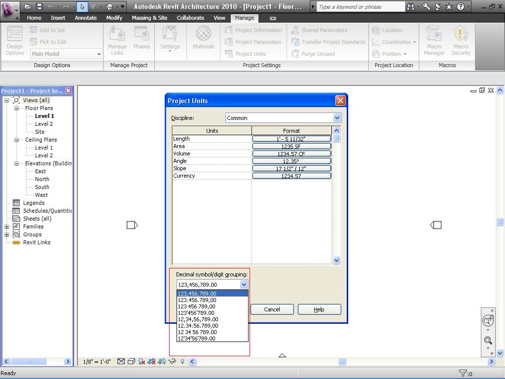

See the attached images...In all the versions you can modify under 'Units' Command.

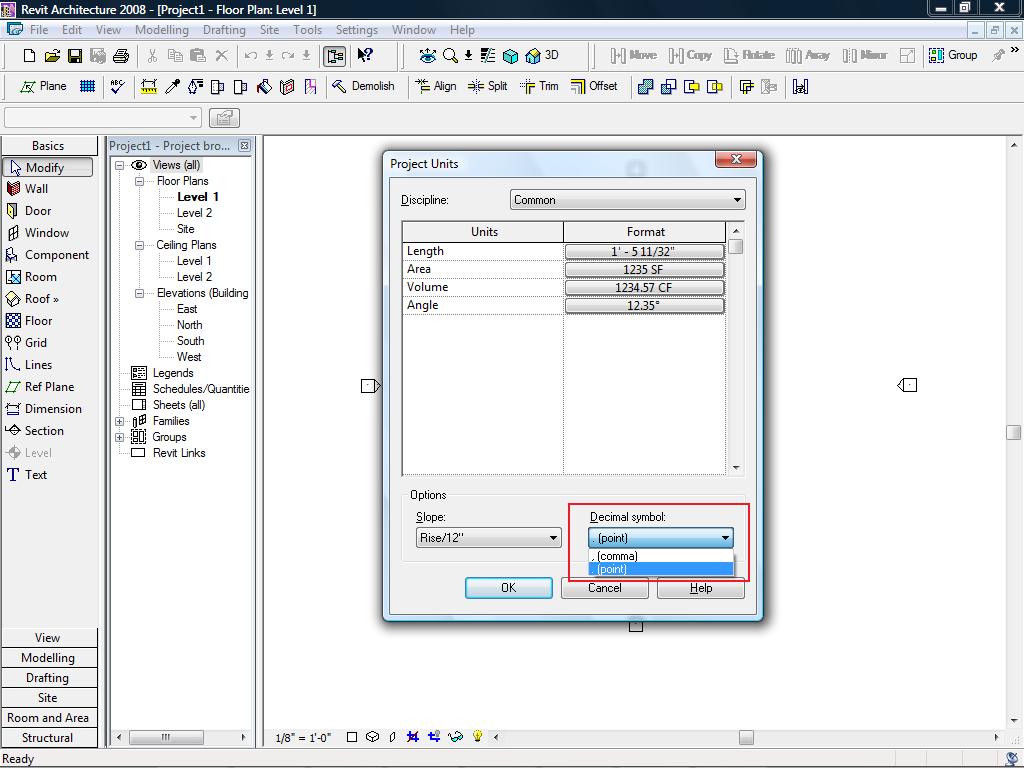

Thank you for the reply, but I this command I already tried and it only puts an additional comma/point when the number is greater than 1000; it doesnt change the seperation itself...But as I can see in 2008 there was this option; so, where did it go in 2010?! :-)

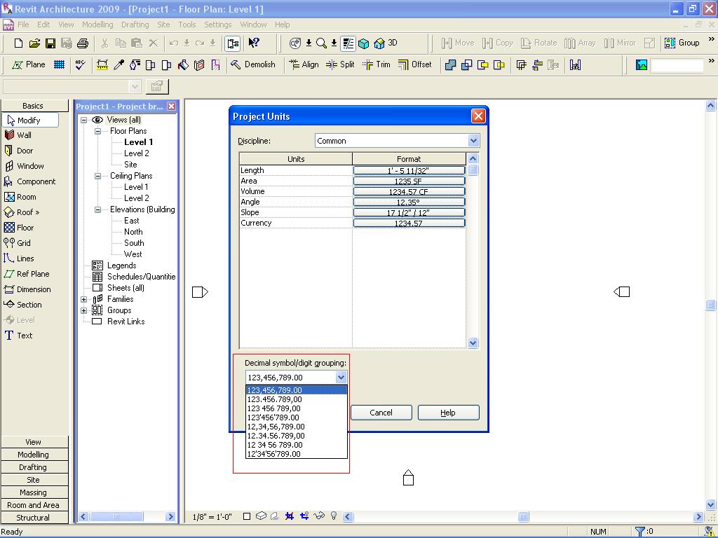

I think this looks exactly the same as what I see in 2009.
