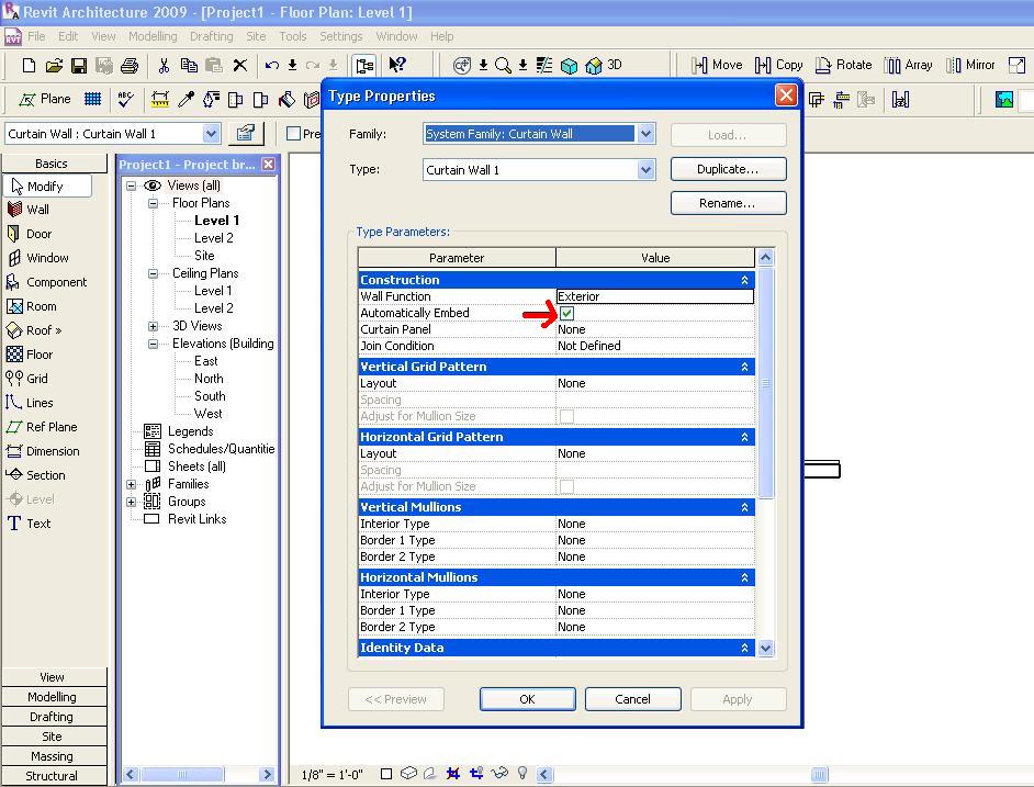

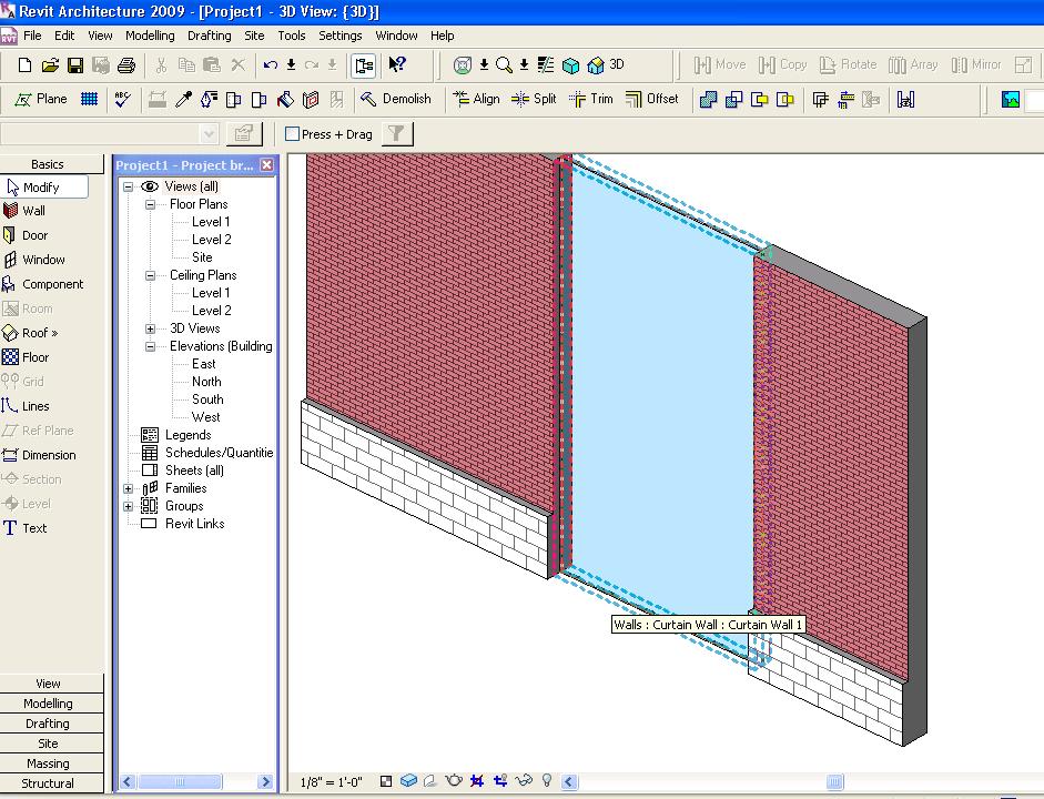

Select the option 'Automatically Embed' in the Type properties of Curtain wall. Now you can insert curtain walls not only in the stacked wall but even in generic walls.

Thanks for the 'automatically embed' !!!!!
worked like a charm
