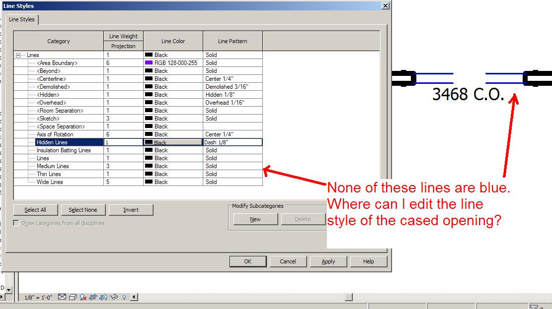

I am somewhat new to Revit, trying to understand how line styles are managed.  (using revit 2010)
My goal is to change the line style of our cased opening family from a solid line to a dashed line.
So- I edit the cased opening family and change the line style from "Doors [projection]" to "Hidden Lines [projection]".  When I load the line back into the project, the cased opening now shows a dashed line, but the line scale is too large for our 1/8"=1'-0" projects.  Now where can I edit the scale of this line pattern?
 Cryingsee screenshot...)
Wed, Jan 6, 2010 at 4:28:38 PM | Manage Line Style of a Door
Settings - Object styles... category....
Wed, Jan 6, 2010 at 4:33:26 PM | Manage Line Style of a Door
ldonkle
Joined: Thu, Apr 16, 2009
28 Posts
Thanks
