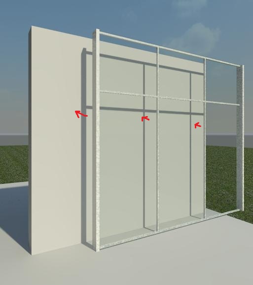

Is there any solution for attaching the curtain wall panels to main wall, concrete core in this case.
I tried making genuine storefront  and changing the curtain panel to desired wall type with finish face exterior I want. The problem than is the system who cuts through the core part.
  http://yfrog.com/iy1cutcorej
What I am trying to do here is to make system panel for my exterior face and than attached it to core wall
http://yfrog.com/132cutj
   http://yfrog.com/jq3a3j
Any help appreciated, thank you.

Create the Curtain wall "Inside" the main wall BUT in the properties of the curtain wall you have (in edit/new) an option "Embeded wall" (i think this is the exact name, i don't have revit here), turn this option ON and it's done....
