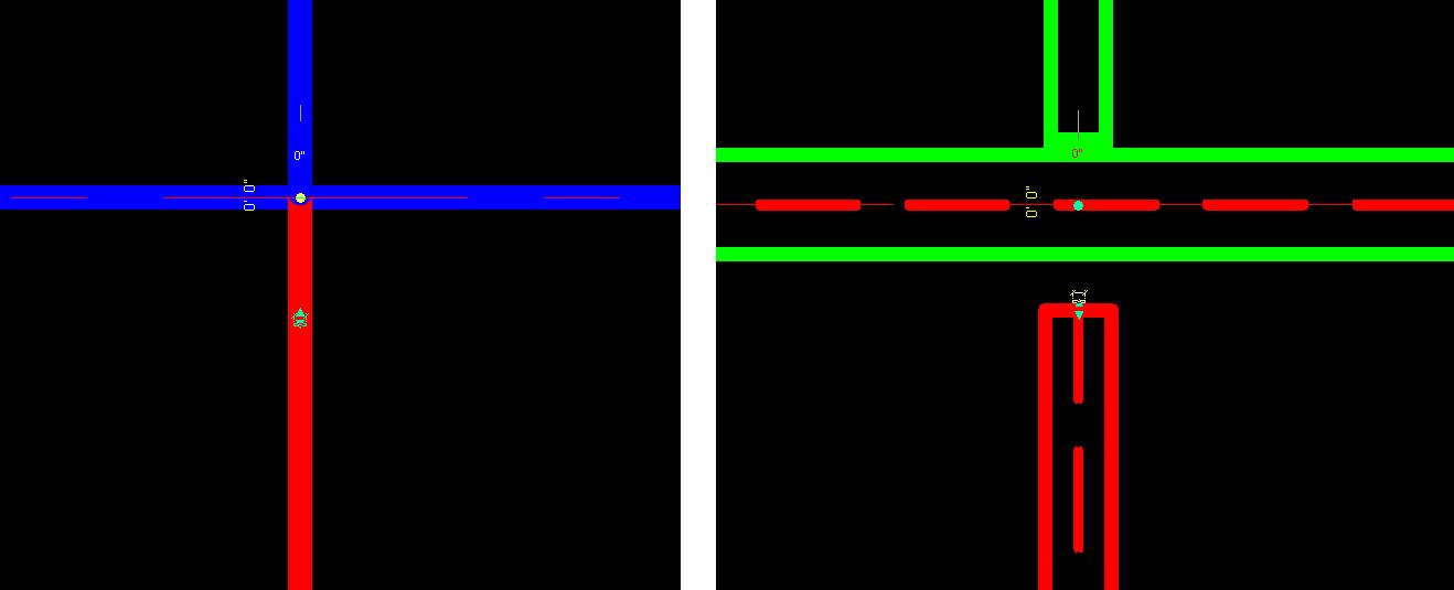

RS2009 - How do I make Revit show a beam pulled back from it's supporting beam (indicating it is hung off the beam) in course view, as typically done on most framing plans?
Attached is an example - the image on the left is course detail (end pull-back is NOT visible), the image on the right is the same connection at medium detail (end pull-back IS visible).

Have you checked your structural settings and made sure that it's supposed to be drawing an offset?
 Also, the offset you see in Medium/Fine has nothing to do with the one you see in Coarse. What you see in M/F is the actual modeled setback, what you see in C is just a graphic representation.

How do I make that graphical representation in Coarse view show the end of the beam pulled back?  Editing the member's "Start Extension" and "End Extension" has no effect on it in Coarse view.

OK, I figured it out partially....go to Settings > Structural Settings > Symbolic Representation Settings tab, and adjust the Beam/Truss Symbolic Cutback Distance.

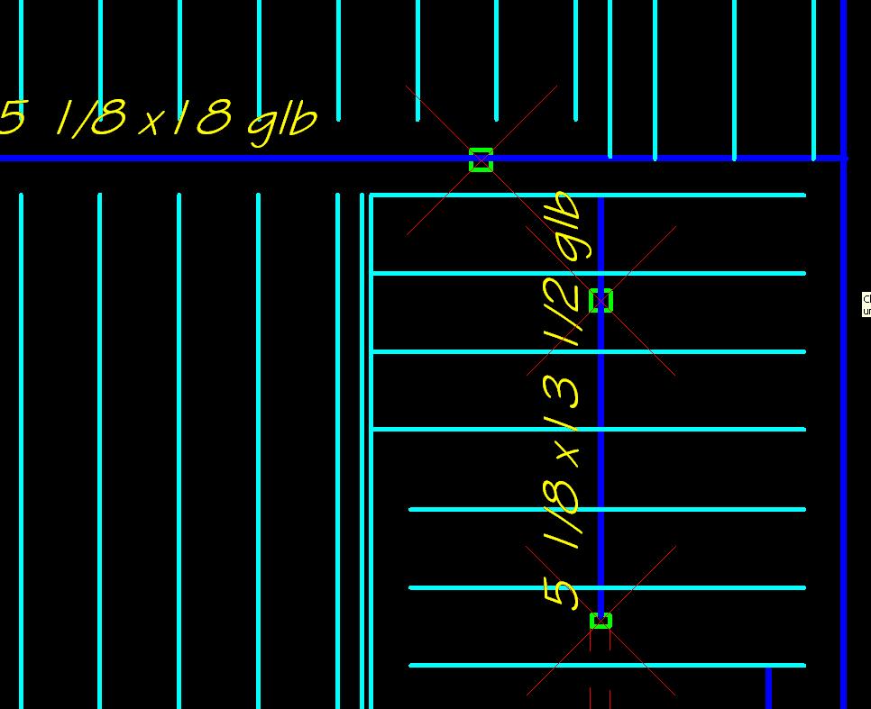

Before, I said the members were not sloped.  Now I'm working on a different project that does have sloped wood roof members.  Some ends are pulled back, some are not (even within the same beam system).  See the attached jpg. Since this is a global setting, I'm confused as to why this is.  You mentioned that sometimes members will display 'oddly' when sloped.  I tried the 'drag and re-drop' suggestion but no luck.  Any other ideas??
