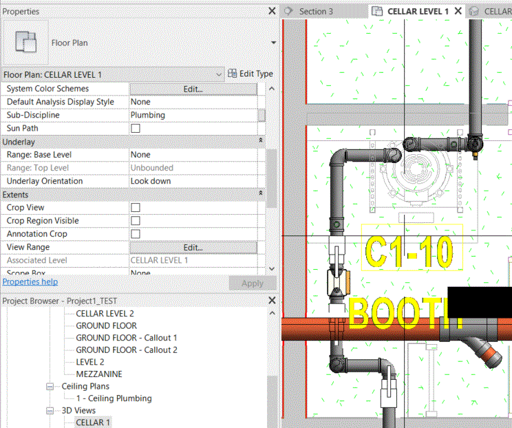

Good Morning,
I have having this same issue on 2020; I see how it is associated with the underlay, but when I set the underlay to none I am still having the same problem, in fact the underlay was always set to none and the special equpment is coming out in grey. I was using the plumbing template and I a few families come out in grey. I have a concrete block that is in grey and a ladder in grey. All loaded components and 1 model in place component all coming out grey.
Please Help!!
