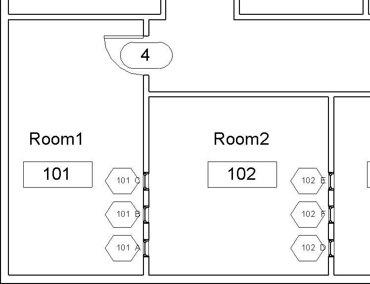

I want to change the window tag for each window so that Room 101 will have each windows tagged differently such as101A, 101B, etc. even though the windows may be the exact same size, etc. I tried highlighting the tag, change it but then it changed it for all the same windows so that the tags are the all the same. (I got this idea from a textbook and can't get it to work). Thanks in advance. John.

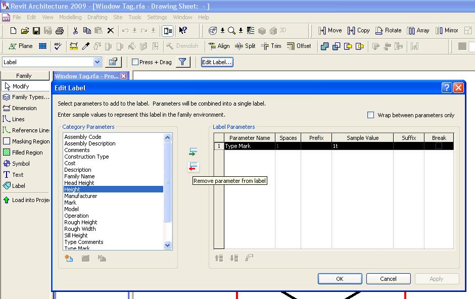

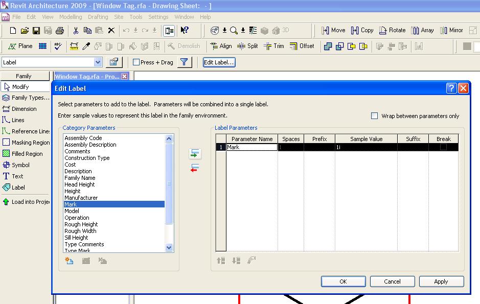

John just select the window tag and click on edit family, In the family editor select the Label and click on edit label, then slect the Type mark and remove it, then add Mark and click on OK. Load it in your project. You can give different names for the same type of window.

I have attached an image below,
JohnAT if i understand you that is what you want to do?
Good news is that its very simple if you do what Pavan sain and change it to Mark instead of Type Mark, but then you will manually have to type in 101 A, 101 B, etc... and then keep track of them which is no way to use Revit.
