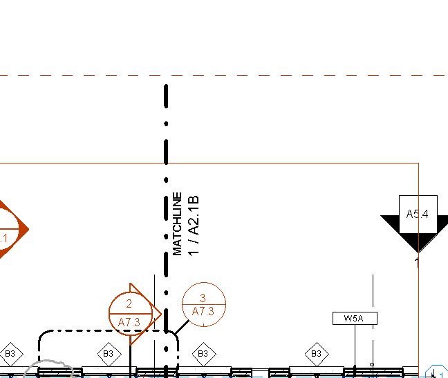

I found this forum because I need to do the same thing. In my case, I am drawing match lines. The match lines are drawn right on the view crop lines.. but at the corners, I want them to expand into the annotation crop zone because it will look much better graphically and be more clear.
I know I can draw the lines on the sheets instead of the views and it will work, but I feel that this could lead to issues down the road if the plans get re-worked or adjusted.
Wed, Jan 14, 2015 at 12:53:07 PM | Annotation lines outside the crop region
#9
If you are using a regular REVIT matchline, it can extend past the view crop window and into the annotation window area.
In the attached, you can see the view crop window, the annotation crop boundry, the matchline and the matchline view tag that works with your dependent shared views.
