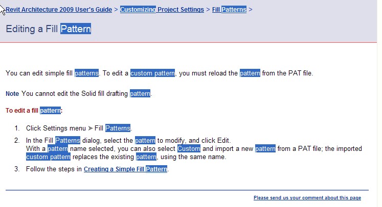

I did that, and located only the following vague sentence in regards to modifying existing pat files.....
"A fill pattern is stored in the file in which it was created. To save the pattern to a template file, open the template file and create the pattern there."

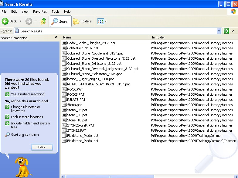

I just did a search through my revit directory to try and locate the herringbone pattern file, but these are the only PAT files in the entire directory (see attached image).
What am I missing?

You won't need HatchKit for this one. Smile Search your filesystem for the file Revit.pat which contains a herringbone pattern. Then load the pattern scaling by 6 and renaming to suit.

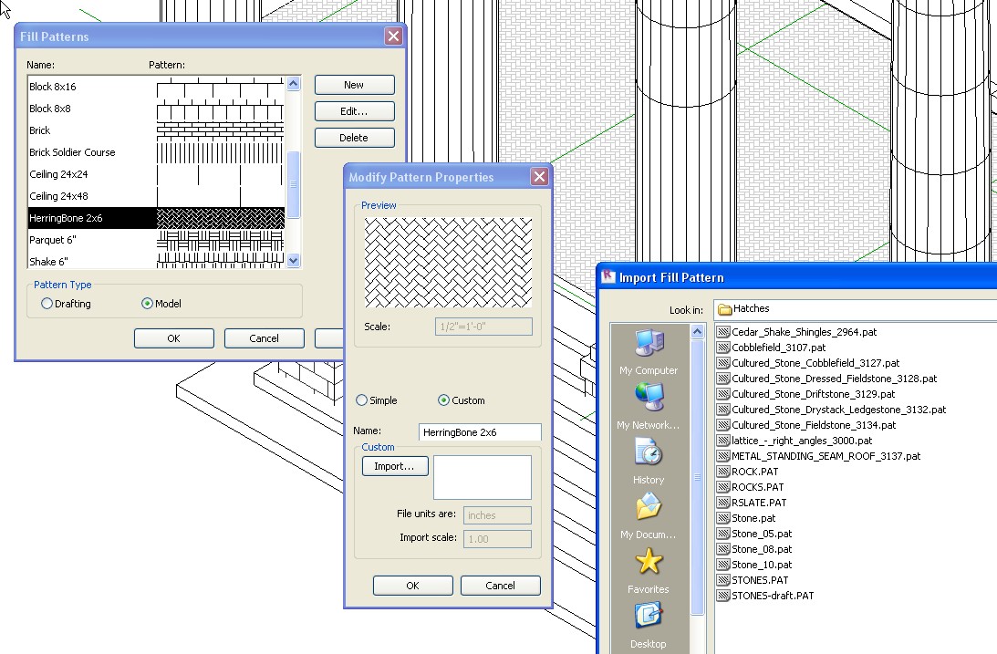

I tried this (see post #4), and I cannot locate the herringbone.PAT file. I know the system is looking for a pat file, and since it's already loaded at 1:1 scale, it seems I should be able to load it again with another scale, but again it doesn't seem to be in the only place where the PAT files exist on my system....IMPERIAL LIBRARY / HATCHES.
See my process in my image below.

" Please note that I said - "Once a file is created, it can be loaded at different scales. "  Just follow the HELP for loading custom pattern files."
I tried every help I could locate with the exception of creating a new one from scratch with the notepad feature (seems an archaic method considering we have drawing tools, but this is another topic).
See my post above for my attempt to load a new pattern or edit an existing one. I followed the help (see attached image). and got nowhere since I cannot loacate the herringbone.PAT file as mentioned in the help.

If you look in your c drive where your program is loaded, you will find a file called revit.pat. And yes... go ahead and open it with notepad.  In that file is a herringbone file.  If that is the file you want,copy (or otherwise isolate) that portion out to a new file (new name) and then load it at a new scale.

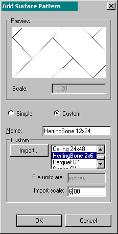

Well, I just got it...For Revit it's amazingly unintuitive. Unlike the rest of revit, which has a right cligk or logical function for everything. It's confusing to actually see the pattern you want to use, yet have an option to scale it greyed out. Then have to find a hidden file and reload it. I guess this is the one time where AutoCAD makes more sense.
I didn't edit the pat file, however I did finally locate the Revit.Pat file by searching my hard drive for hidden files, and it came up!
For those viewing on a search after having this difficulty, here are the steps if you want to load an existing hatch at a different scale.......
1.  Settings / Fill Patterns
2.  New / Custom /Import
3.  Browse to Revit.Pat file (mine was in my Data directory of my Revit install loacation
4.  NOW all the model pattens will show up (finally), and you can create a new one at your scale after renaming it.
