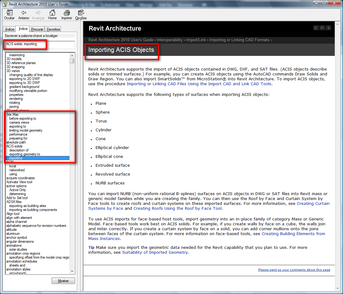

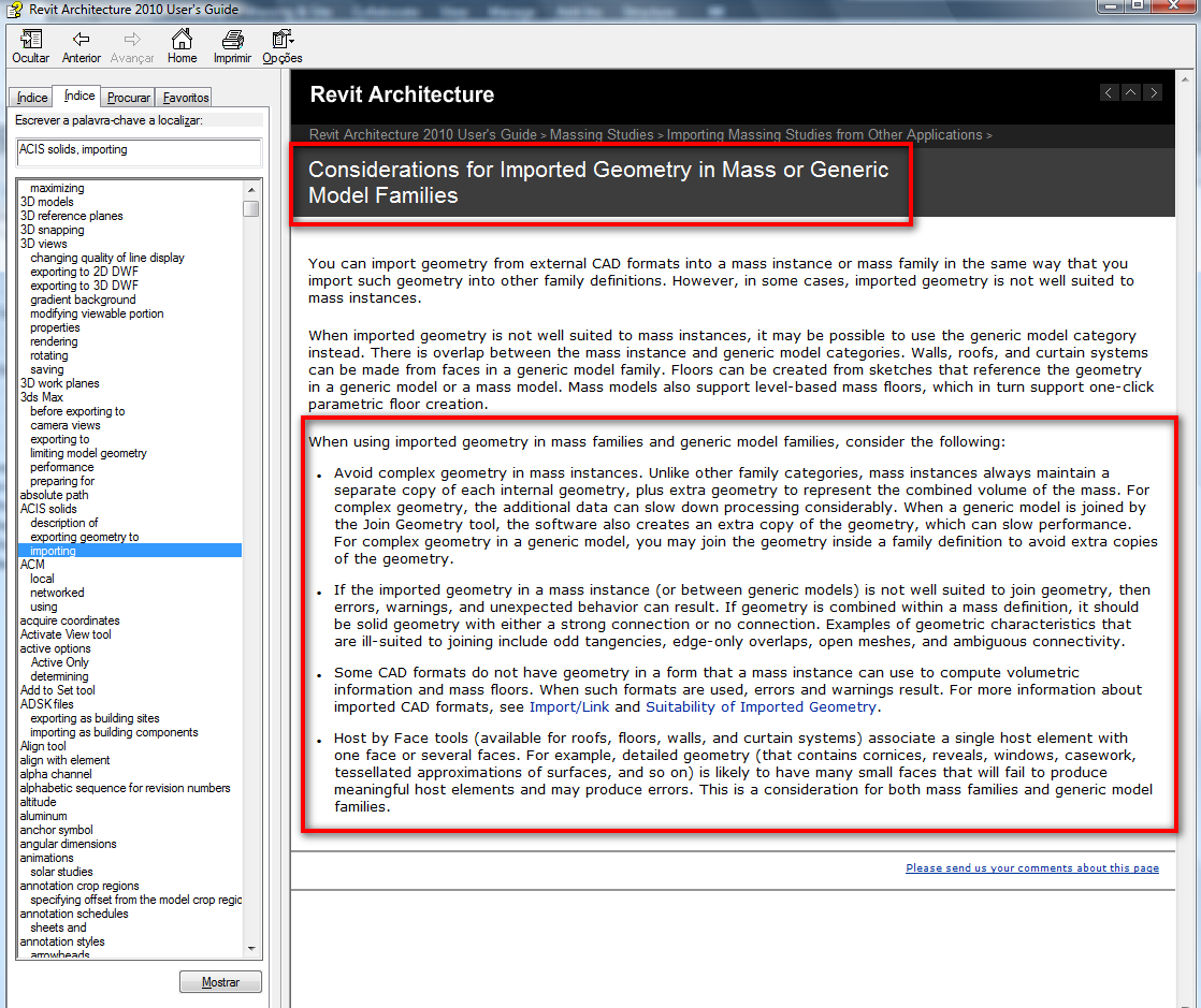

I think You should read the HELP menu first....

Huh, Help file??? That's crazy...
