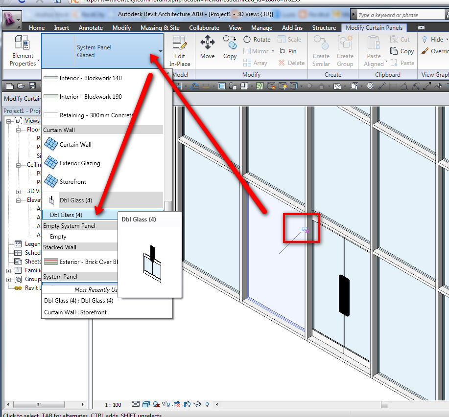

You CAN'T use a "Normal" Door to insert in a panel of a Curtain wall, you must use or CREATE a "Curtain Wall Panel" like you can see in the image attached....

Ohh, sorry, pick in the Panel and UNPIN that panel, then you can select the "door"....

Look my image above...
Curtain Wall Panel to Curtain Wall Door
