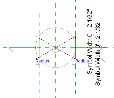

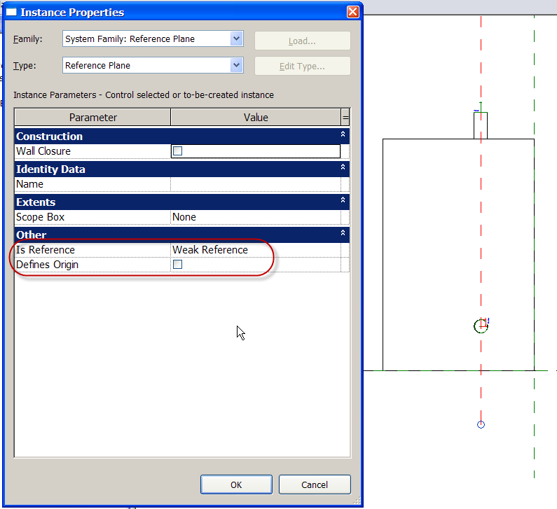

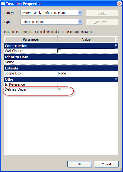

Hello, by default, it is the intersection of the Center Left/Right and Center Front/Back that defines the insertion point of a Revit family.  When you drag an out-of-the-box valve around the screen you will see that it has a center insertion point.  If you open up the family and take a look at it, the center of the valve is found at the intersection of the two primary reference planes.  If you drag an out-of-the box boiler around however, you will find you are dragging it around by the bottom-left corner.  If you take a look at it in the Family Editor, you will find that it was drawn with the intersection of the two primary reference planes at the bottom lef-hand corner of the part. So, a simple solution would be to examine the parts you are having problems with in the Family Editor and see where they are sitting in relationship to these two planes.  If you still have problems, you might also look at the properties of the reference planes in these custom parts.  If you select the two primary reference planes for an an out-of-the-box part, right-click and select Element Properties you will see that they actually have a property checked on called "Defines Origin."  On a custom piece, someone may have unchecked this property and they may have set other reference planes to define the origin, thus moving the origin, or insertion point of the part.  You should see that the properties of minor reference planes such as those that help define the location of components on a part as weak references and they should not have the property "Defines Origin" checked as in the example of the boiler below.  Following are some screen captures that illustrate what I mentioned above.  Hope it helps.

I disagree with JillBernhardt about what is right or wrong with family origins.  They do NOT have to be at the junction of left/right front/back.  The origin should be where ever it makes sense for the family in question.
Jill does explain correctly how you define the origin so uncheck to origins where they are now and redefine them as they should be for your element.  Add new reference planes if you need to.  Just be sure you name your new planes for later reference.

Sorry for the confusion.  I did not mean that the origin of a family has to be at the intersection of the two primary reference planes, but, they are in all of the out-of-the box families that I have ever seen.  So it would be less confusing to users who share your content perhaps to move the geometry to mimic the standard in the software, such as the boiler example I showed.  But, you can do whatever you need to do by controlling the Defines Origin property previously discussed.

Ok, this is helpful.  I had established that the intersection of the reference places was giving me the origin, however, i was unable to adjust this intersection and have that reflected within the family when placing the family in my model.  the problem has been alleviated by toggling the "defines origin" box.
