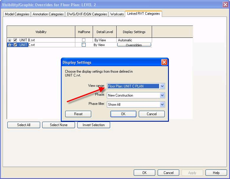

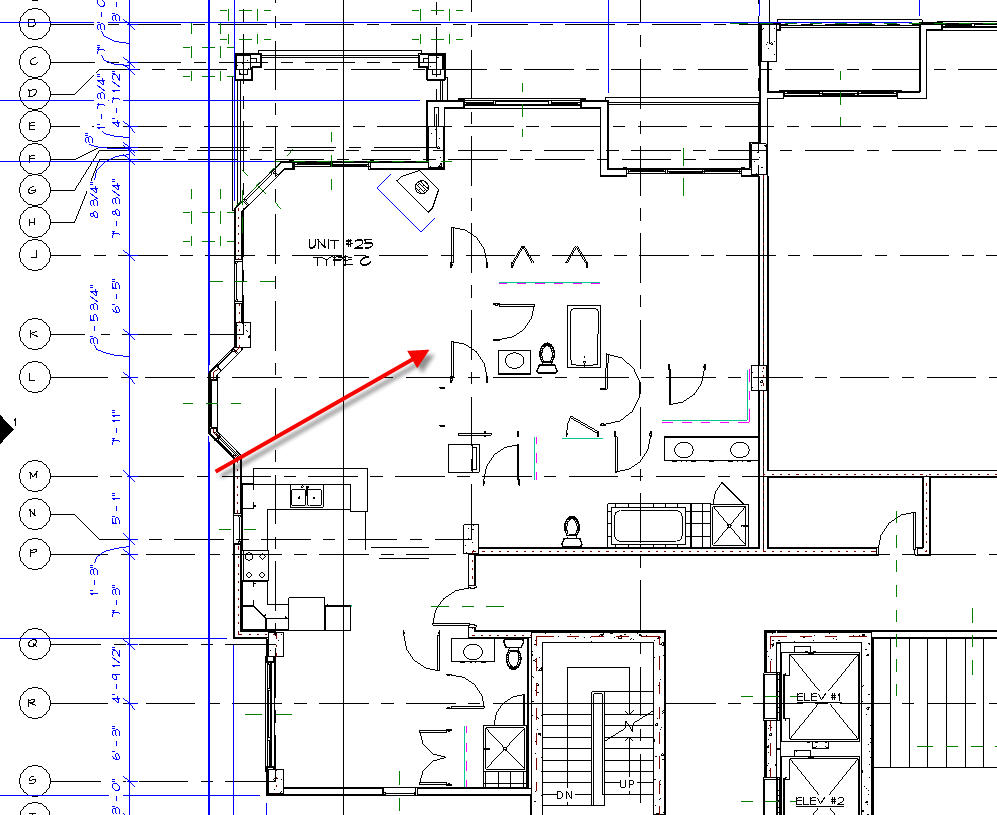

In 8.0 I am linking a unit plan into the building plan file then mmirror it and it shows up fine on the first level. Wehn I copy clip to the second level the origional is fine but the mirrored ones walls diapear. What is the problem. I have done this before in 6.1 and never had a problem. Please can anyone help me?

Are they there in 3D? If not send it to support as it looks like a bug.

yes they are there in 3d! Actually i found that if I go to Visiblibility Graphics and under rvt change the display setting from automatic to the linked file it works. (see image)
