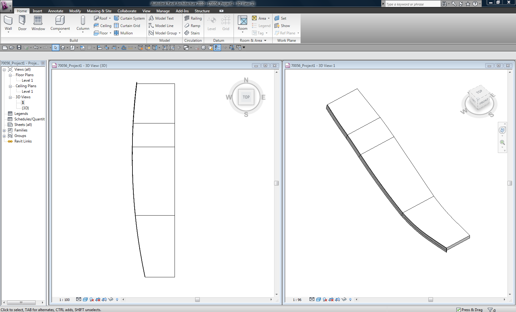

Does anyone know how to create a roof fascia that curves 2 directions?  I haven't been able to do it with the roof fascia tool.  I thought maybe creating a thin roof outbourd of the edge of the roof would be a quick workaround but roofs don't let you include a profile, which I need.  Any ideas?  I'm using Revit 2009.

What do you mean curved in two directions Curved in plan or elevation?

The problem with a sweep is that it only lets you create a path in 2D, not 3D.
 I've attached a revit file for reference.

Yep, now i see what you want, use the create in place like Erland said and it's done...

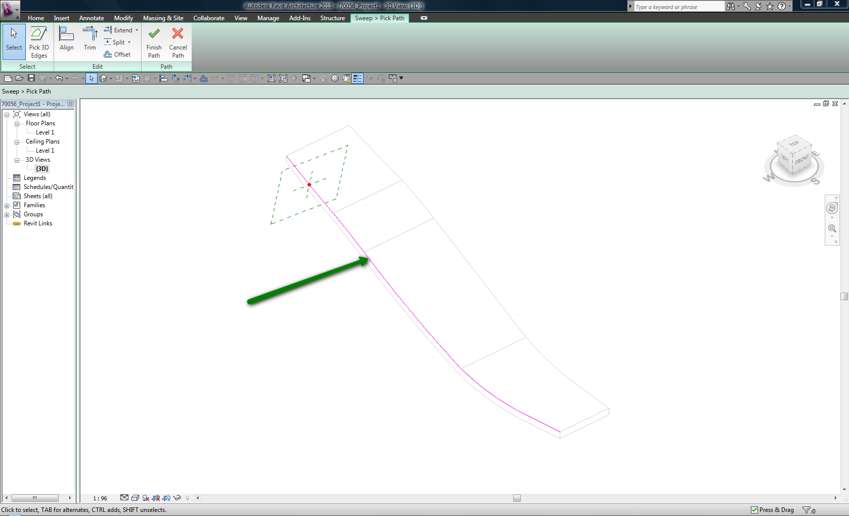

A sweep can have a 3D path, but only when you use the pick command for the path...

LIKE SPOT SAID, FOR THE PATH YOU WILL HAVE USE PICK 3D EDGES.
