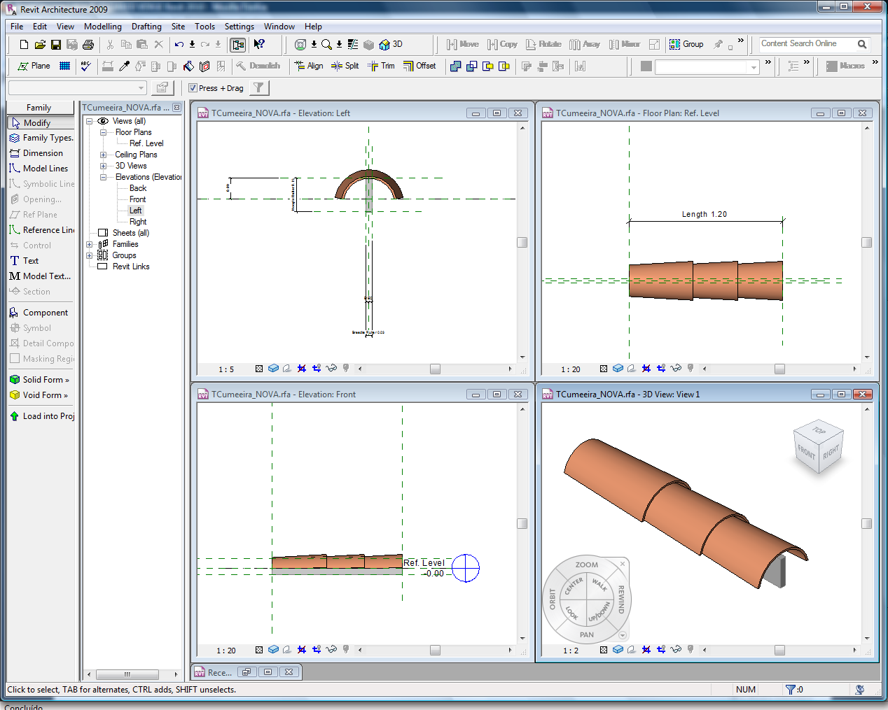

Check this Generic Model Line Based family, look how it was created and change the shape like you want...
