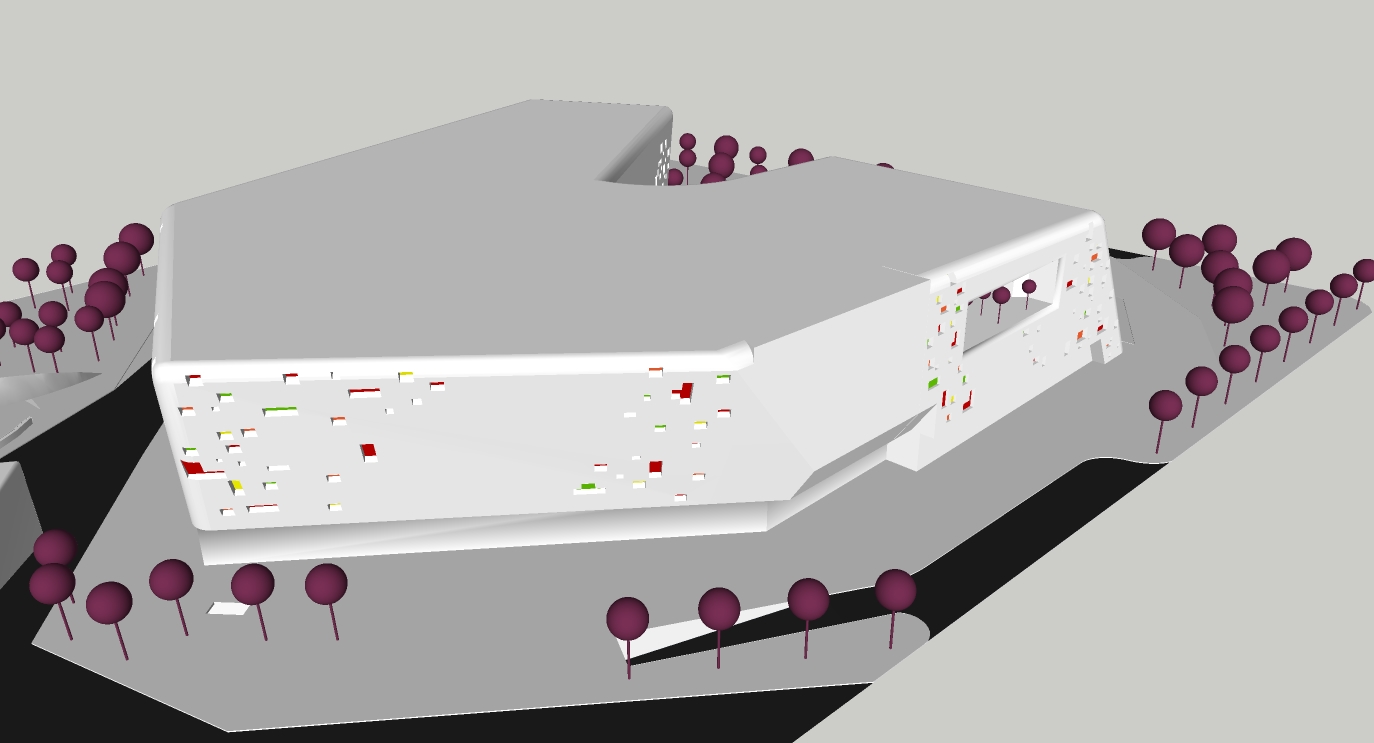

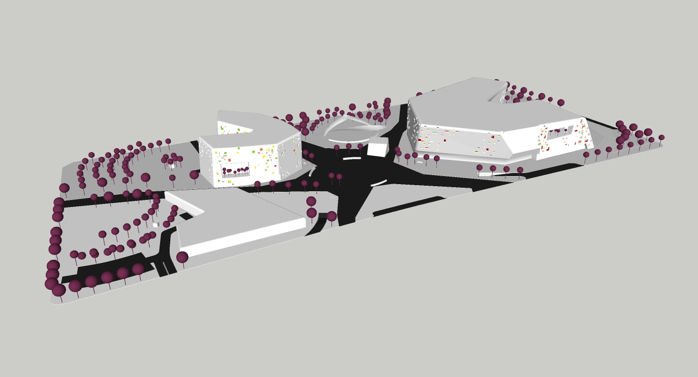

I tried exporting a skp file to revit, i was actually successful. The thing is, I cannot edit any of the surface. When i click one line/segment, it just selects the whole thing ( as if "grouped"Winking in sketchup terms. Do you guys have any ideashow i could edit it? I'm using Revit 2009 & 2010 and Sketchup pro 6 by the way.
 I wanted to put a diagrid on the mass for structural puroses.
Please help! Thanks a lot!
here is the whole project by the way:
mambo.harts.u

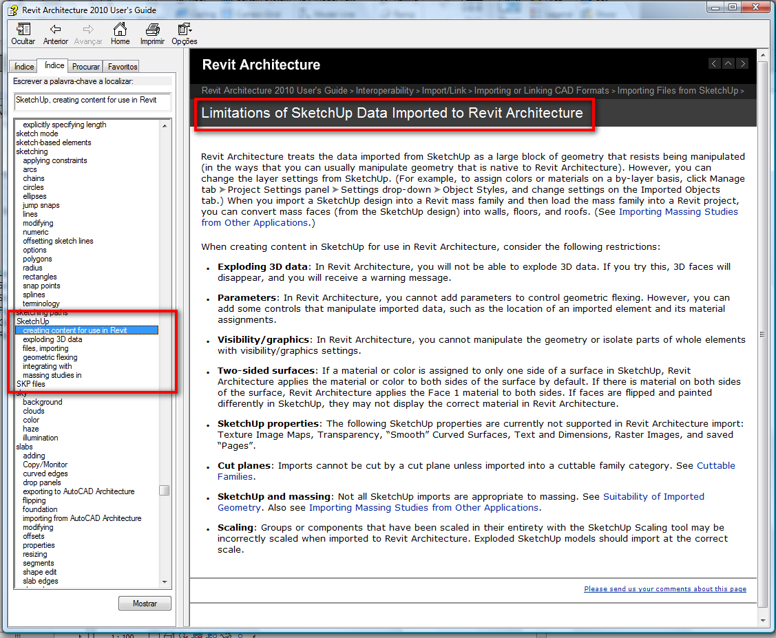

I think you should read the HELP menu first.....

You should read this as well..... http://forums.augi.com/showthread.php?t=87524
