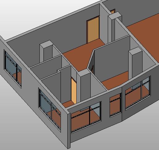

Iam new to Revit system, currently start to use the revit 2010, is the a way to show the doors in a open position in a 3d view? for a presentation purpose i try to make a rendering in a 3D view but i cant make to open the doors.
 for any help thanks
Glenn
Fri, Dec 4, 2009 at 9:45:24 AM | Question, please
TKennedy
Joined: Wed, Oct 7, 2009
654 Posts
4 Stars: 8 Votes
The open door swing you see in plan is created with sybolic lines, the door panel is modeled closed. If you want it to be open you would have to edit the family.
