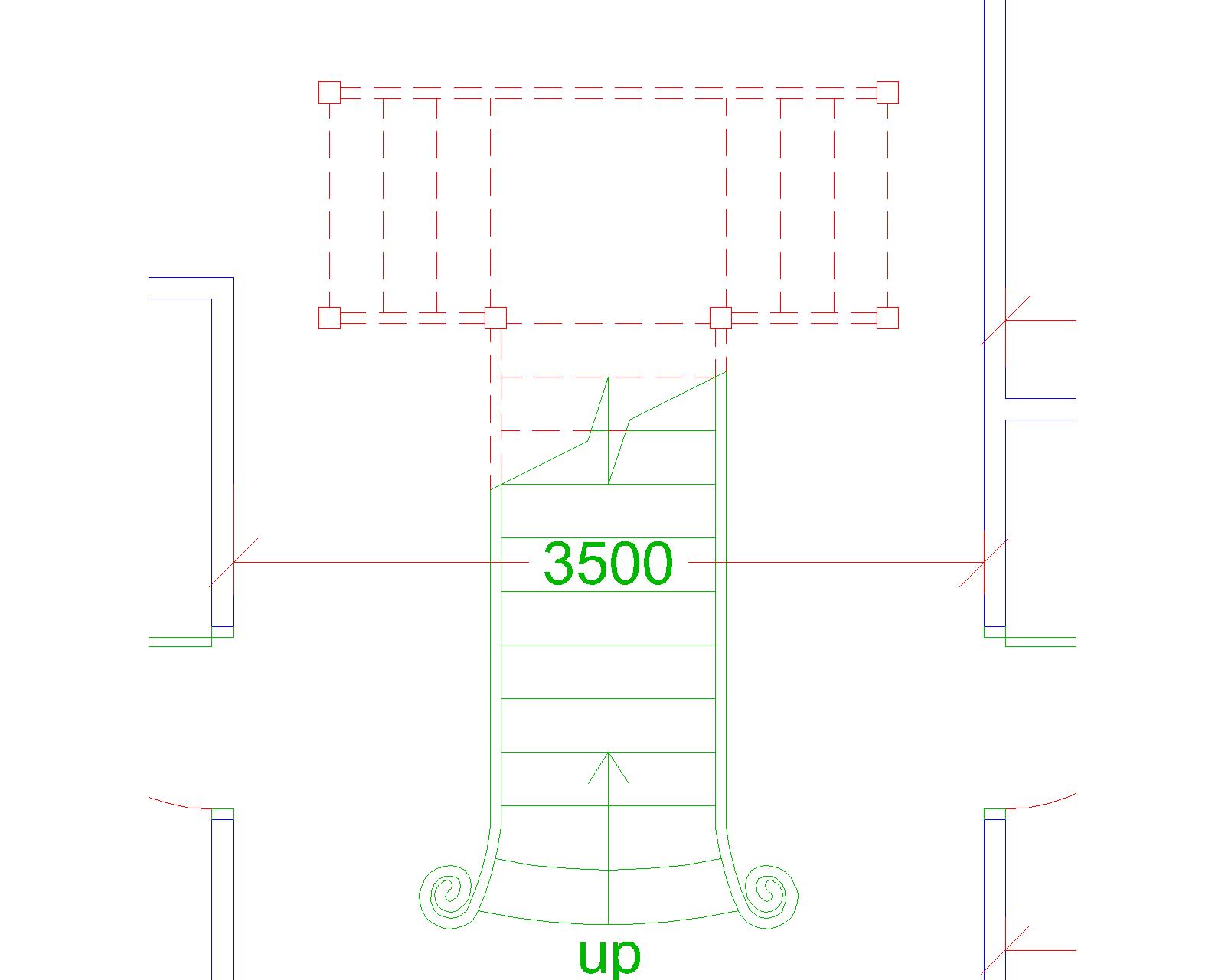

Hi all.
I'm pretty new to the world of Revit, having just made the dreaded switch from AutoCAD. For the most part I'm finding it pretty easy going which is a blessing.
Anyway, I'm trying to make a stair like the one shown in the image I have attached. Basically, the stair starts out as normal, and splits in 2 directions after the 12th riser. Can anyone tell me how this can be done while avoiding tearing my hair out at the same time?
Thanks in advance.
Neal.

You will need either 3 seperate stairs or two depending on how you want to handle the stringers.  I would do it as three.  The first gets you to the landing then do one leg and mirror that to get the other leg.

Àlso, how do I go about creating the landing? Do I do it indepentantly of the 3 stairs?

You might want to create the landing with a floor type.. that's usually how I do it. And I think 3 stair strings would be easiest, like WWHub said above. I just did a similar stair, and it worked for me. Also, if you create the railing as one solid piece (on each side) It will come together better...

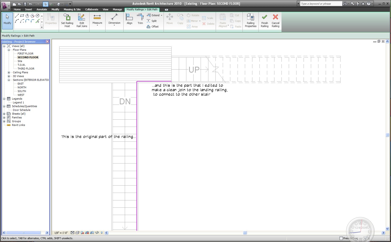

Now for my next problem (it's never ending). Because my stair consists of 4 separate stairs (you know what I mean) how do I get my railings to join up at the corners?

You can create a third, smaller piece of railing to join the two stair railings, or you can 'edit path' of just one railing to extend out over the landing to connect to the other railing.. I have found that you can't join railing elements though. Just adjust the path sketch to look right. If you have a stair with an end baluster, you can create an almost identical railing that doesn't have a baluster on one end (that way you don't have a railing with a double baluster).
That was just about clear as mud, but I hope you see what I'm getting at. Sometimes Revit doesn't to things automatically or like you want it to, so I've learned. But I love Revit.... I'll never go back to AutoCAD. Smile

Here's a screenshot of what I was trying to say...
