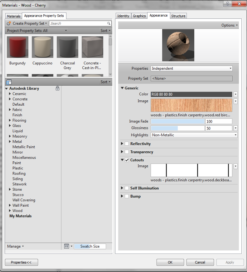

There are alot of good wood material images in your Mats folder. I pick one of these and then apply a simple cutout image that I made in Paint!
