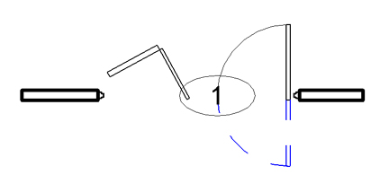

I'm working in 2010, building an ICU door family with two folding panels and one swing (based off of a Horton Automatics cut sheet).
It looks good in the family editor, but when dropped into my project the symbolic door swing lines go awry.  I'm not sure how or what constraints I should put on them.
Attached is an image of the in-project whacked out results, and the door family itself.
I'm grateful for your input!

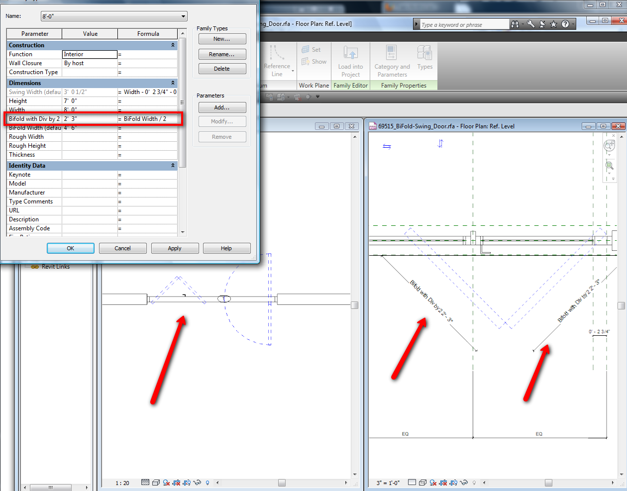

I think this solve your problem???

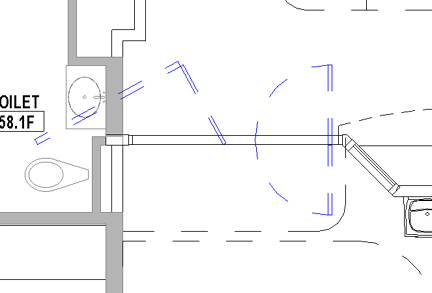

Typhoon, thanks for the help.
Unfortunately, this doesn't seem to solve the problem.
Attached is a file of the updated door placed into a generic project.
I appreciate any additional thoughts!

Wed, Dec 2, 2009 at 12:58:20 PM | BiFold Swing Door family - whacked out
Joined: Tue, May 22, 2007
5921 Posts
4 Stars: 205 Votes
Ok, see this: http://www.megaupload.com/?d=TI87VWN3

Excellent!
Thank you, Typhoon!
