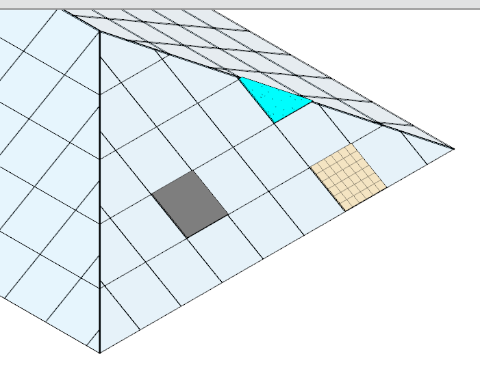

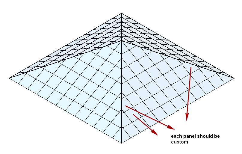

I have to create slope roof with custom panel.
 But when I attach custom panel to this roof I received message - Program not to insert cusrom panel in non-rectangular cells.

I don't know what's the problem with you, maybe those Panels are not created correctly...

I explain.
I created custom panel (the panel should consist 3layers) using Metric Template - Panel for curtain wall.
In my project I created curtain roof  and attached this panel.
The programm gives to me a message about fault .

Can you put here that Curtain panel so i can take a look?

I put panel. This panel it is necessary to use in roof.

Sorry for the delay, see this: http://screencast.com/t/YjRmZGFiMmU

Thank you!
It's very usefull.
