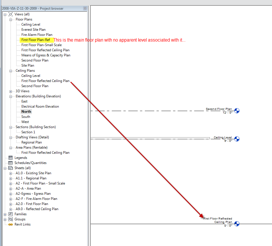

 I have a project that I haven't worked on for a while.  I believe that I just renamed the "Level 1" to be "First Floor"  and started drawing walls and such on the First Floor Plan view.  Most of the representation of walls are in fact a referenced AutoCAD file from another architect who did the original building shell.  Now I am drawing in Revit Wall so that I can finally delete the AutoCAD reference floor plan.
 Now when I create a section, the default "Level 1/First Floor Level" line and Level Icon are not visible...  Also when I check the properties of a new wall, the Level 1/First Floor level does not appear in the list and it has the new walls anchored to the "Reflected Ceiling Plan" level....  The only level that appears automatically on the new sections is the level for the "First Floor Reflected Ceilling Plan" that I just created.
On a section, how can the default and levels in use be made to appear?  I am hesitant to just create a new level and call it the first floor line if it already exists somewhere... it must exist because I created a floor plan view and that specific level is not appearing on the sections...

Hi Chris,
 I followed your instructons the letter and no additional or hidden levels appeared in the elevation...  Please see the attached screenshot.  This is really odd...

Tue, Dec 1, 2009 at 1:42:50 AM | Levels not visibile in new sections... Help
Devonshire
Joined: Wed, Nov 28, 2007
46 Posts
The (previous) attachment shows that when I change the name of the reflected ceiling plan it changes the name of the level at 0'-0" to that same name....
Architect
Tue, Dec 1, 2009 at 8:54:21 AM | Levels not visibile in new sections... Help
When you rename an associated level view, Revit asks you if you want to rename the level and views.  You do not have to say yes.
