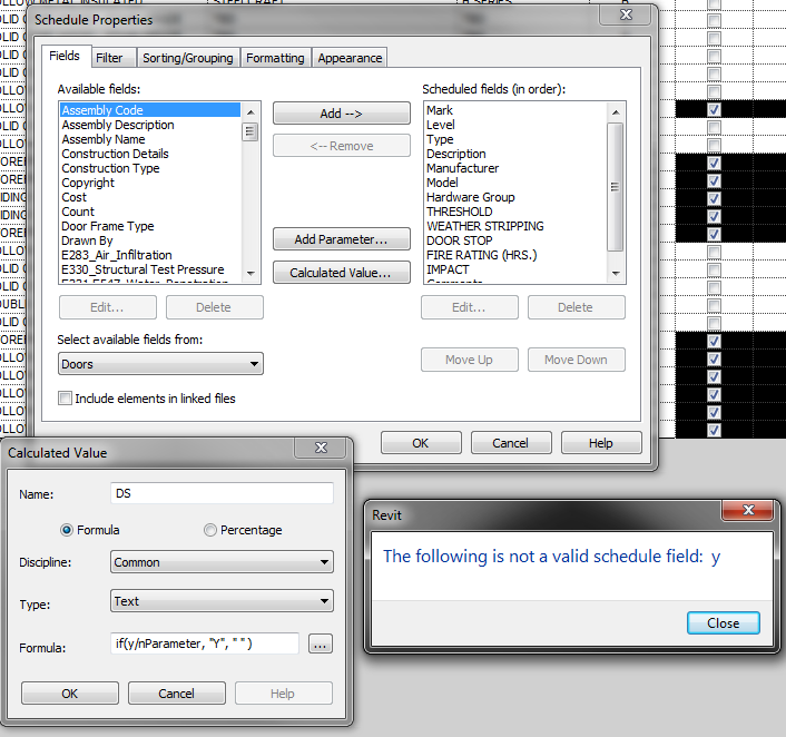

This thread is old but when I put "if(y/nParameter, "Y", " " )" into a calculated Value I get "The Following Is Not A Valid Schedule Field)  Thanks, I am certainly the one at fault.....just ask my wife!

You took that too literal.  You need to replace "y/nParamter" with the actual name of the y/n parameter in your schedule.  For example, based on the photo you attached, if "THRESHOLD" were your y/n parameter, then you would use the formula: if(THRESHOLD, "Y", " ").
Good luck.
