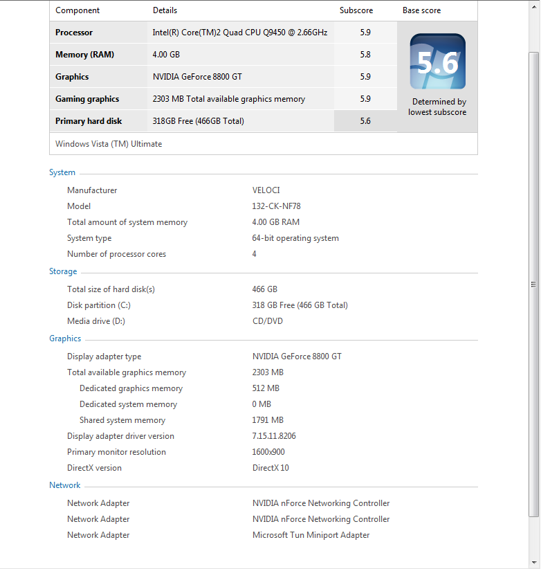

mbsteve
mbsteve Avatar
Joined: Fri, Sep 22, 2006
759 Posts
4 Stars: 13 Votes
I am pretty happy with the attached set up.
