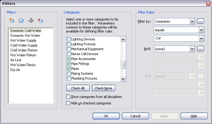

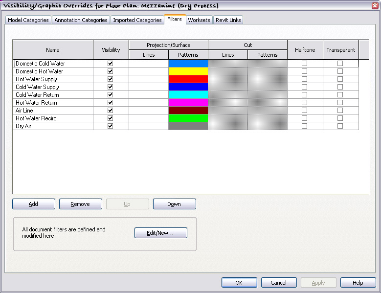

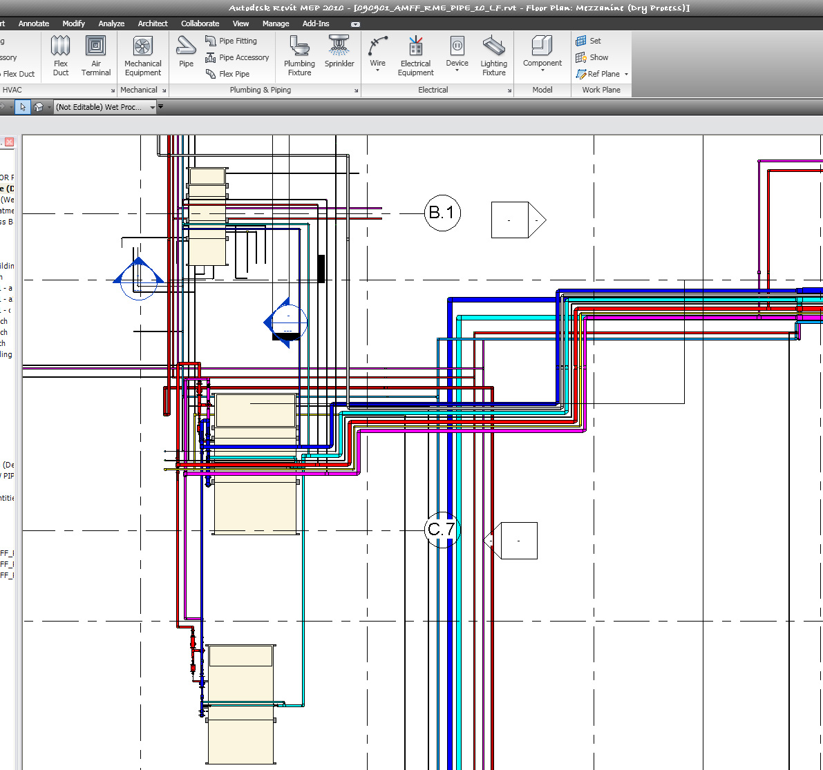

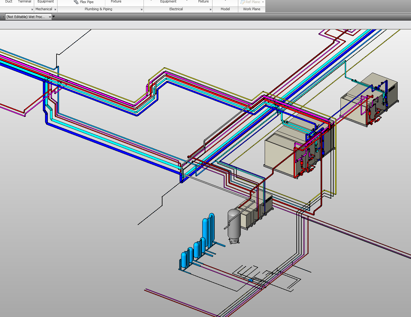

I usaully create filters with different colors for each type of system. Then I just set the filter to read the COMMENTS property of all the families in the pipe catagory. Then in the view(s) I add the filters in the visibility / graphics dialog and then just type in the comments property the abbreviation for the system.
See the attacched images for examples.

I like this filter image better.
