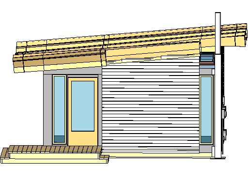

I've included an image of the of the problem where the siding, because it is cutting this way, is sticking through my roof assembly. As well as an image without the roof.

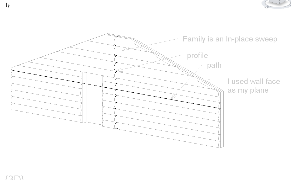

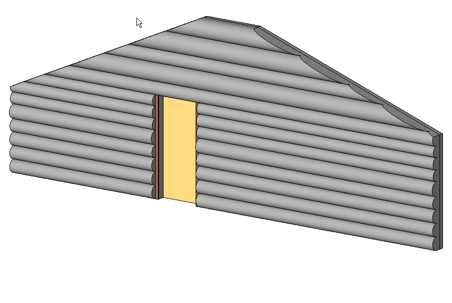

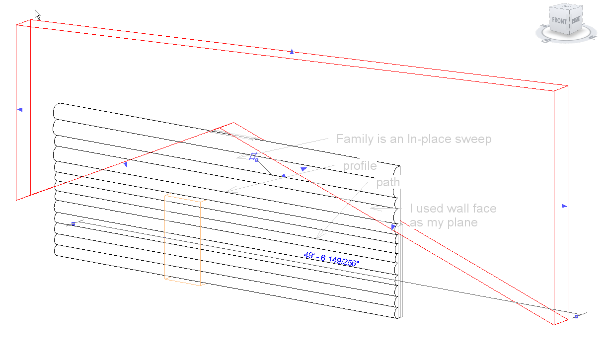

What you have included as images and description are very hard to follow.  That being said - wall sweeps don't work well for items like this for just the reason you are describing.  In addition, most people will not model items like lap siding.  No reason to since they will render correctly with a material application and elevations work fine with simple wall pattern.
If you must model this, look a one in place sweep or extrusion that forms all of the siding at once combined with a void to cut the ridge angle.
Here is what I posted for a similar problem.
68907_ScreenHunter03_Jun._17_13.14.gif68907_ScreenHunter04_Jun._17_13.14.gif68907_ScreenHunter01_Jun._17_12.59.gif

Ah, thank you. Yes, sorry about the images. I exported the wrong view apparently but you got the point I was making. And yes, I need to actually physically model the siding.
