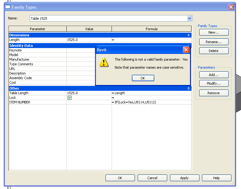

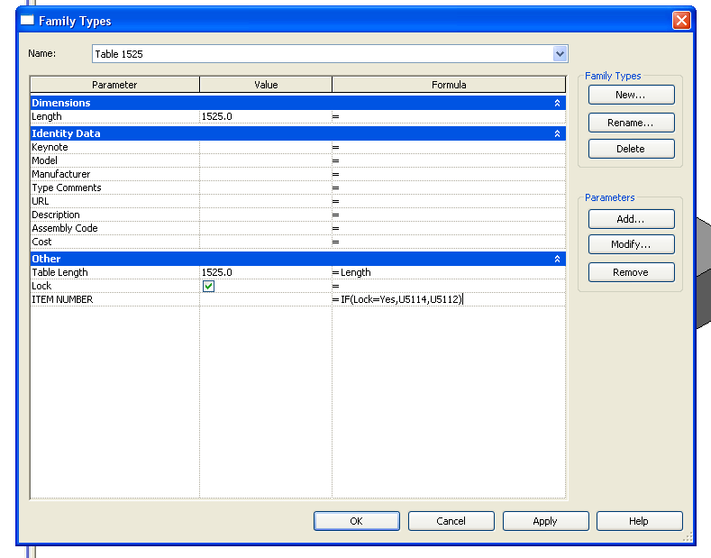

Somebody please advice on the issue below:
 E.g A cupboard has a parameter “LOCK” which can be set to true or false, if we set that to false, the cupboard shows up as “U5114” in bill of quantities, if we set it to true, it shows up as “U5114” and “LOCK1”.
Now on the implementation stage....

See attached snapshots for more details

Wed, Nov 11, 2009 at 6:49:03 AM | Family - conditional formula
Wit conditional yes no, you don't need the =.... just If (Lock,result1,result2)
