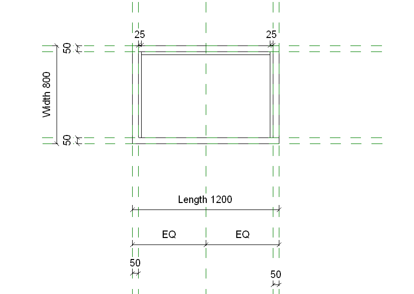

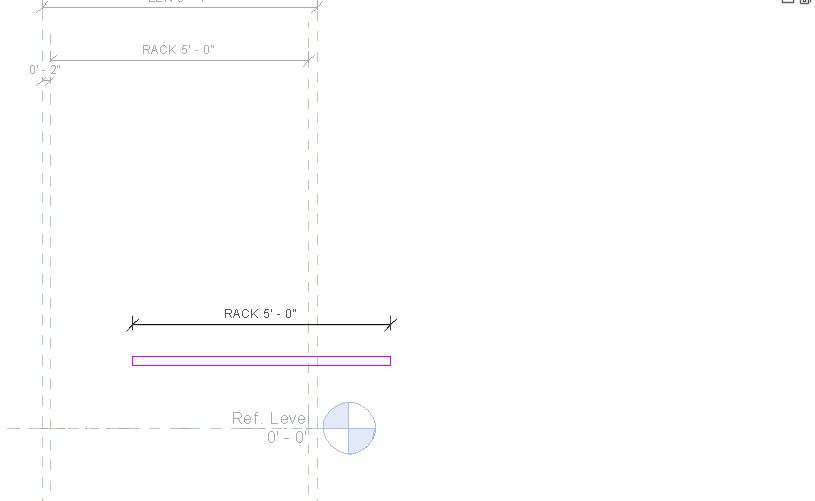

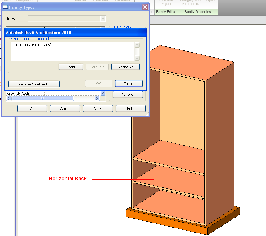

I am trying to create Revit funiture family usinf revit 2010.

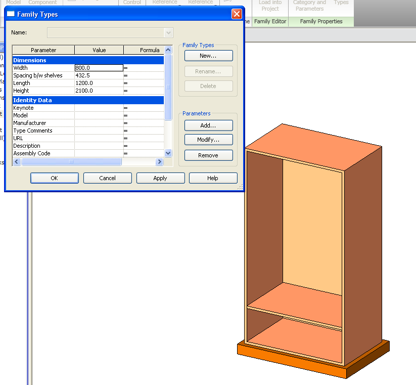

Snapshot1 - When i change the length everthing is oK.

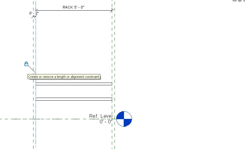

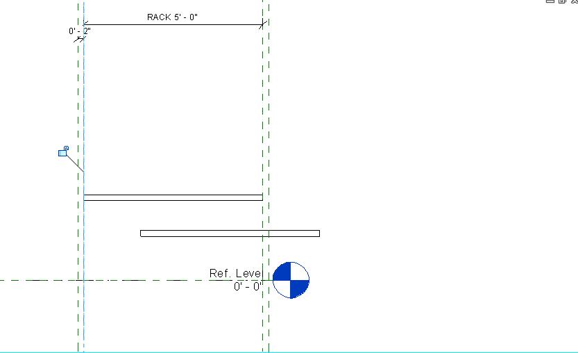

Snapshot2 - I am using the ARRAY command for horizontal rack, now if i change the length its giving me error.
I have also attached plan view for more clarity.
Please help. Is it the problem with the array? May be i am doing it in wrong way...

After you create the Array you MUST "constrain" the second "Piece" in X,Y and Z, use the "Align" tool to constrain the left and right side of that second "piece"...

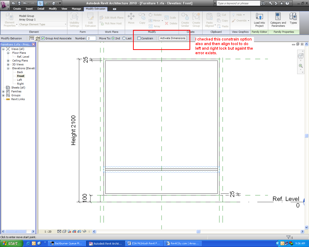

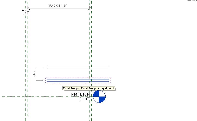

Sorry Typhoon. I have already tried this option but its not working.
See snapshot 3

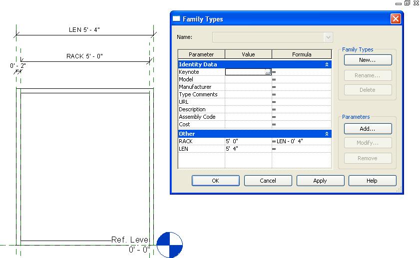

Check the self explained attachments.
