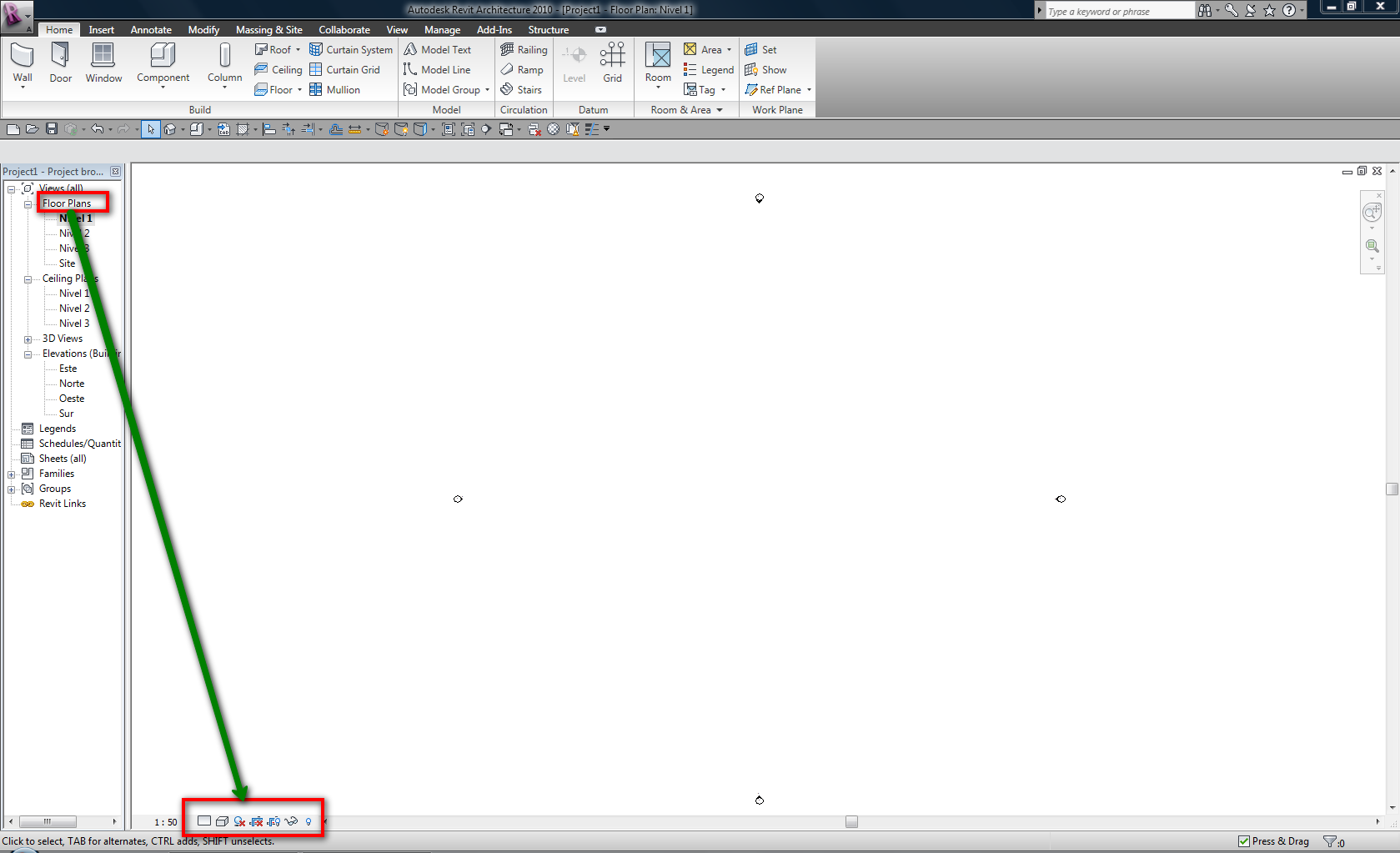

When I downloaded Revit Architecture 2010 about 2 months ago, I (thought) I had rendering capabilities.  Then about 3 weeks ago, it's like the rendering button (the little teapot at the bottom of the screen) just vanished.  I can't figure out how to render anything, now.  Did I somehow disable my rendering capabilities, or did it just never download to begin with and I just thought it had?

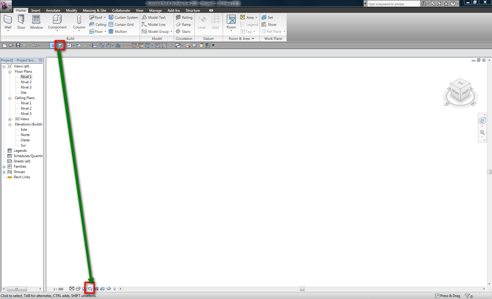

Hi kkaufma3, just a question......are you sure you are not in a plan view or an elevation?, 'cause you won't be able to see the teapot but if you go to a 3D view then it'll appear again, I repeat, just a question. But in anyway, you can also use the shortcut RR to get the Rendering Dialog Box....

That was it lol... I guess I was always trying to render images in 3D, not 3D VIEWS.  Now I know you can only render in 3D Views.  I was wondering why the teapot wasn't there...  Thanks so much!!  You saved my sanity.
