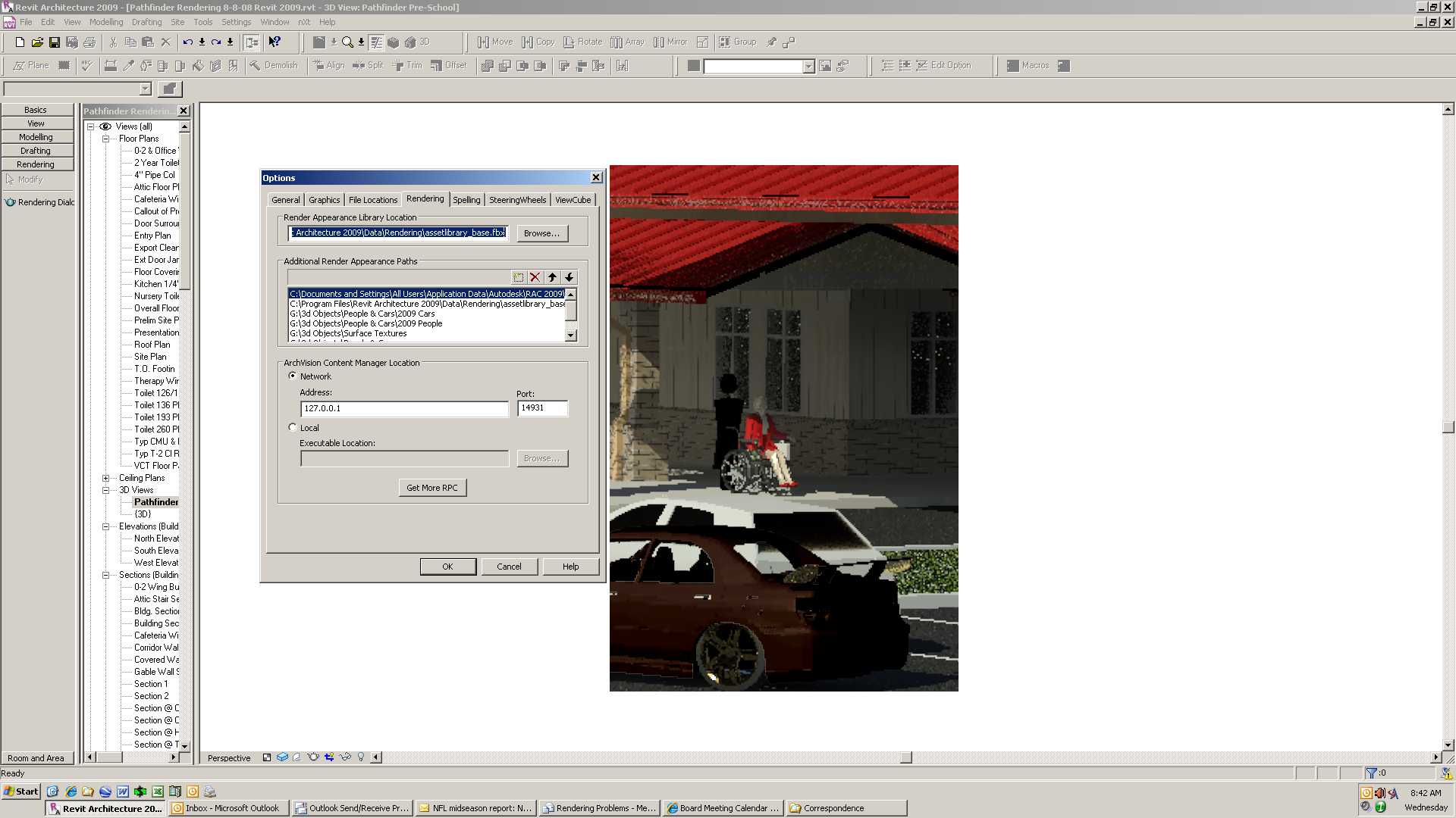

I am going to Settings, Options, Rendering, and being sure that under "Additional Render Appearance Paths" that the location for the folder of RPC people families is listed in that box.  Still have problems rendering the RPC people, but not the RPC trees and shrubs.  What am I missing here?

I have attached an image of a draft rendering showing the problem and showing the Option box where I have attempted to place all of the paths to RPC content that might apply to this problem.  Is there somewhere else I need to be placing paths?  You can see the successfully rendered figures in the two cars and wheelchair person, but not the RPC figure.

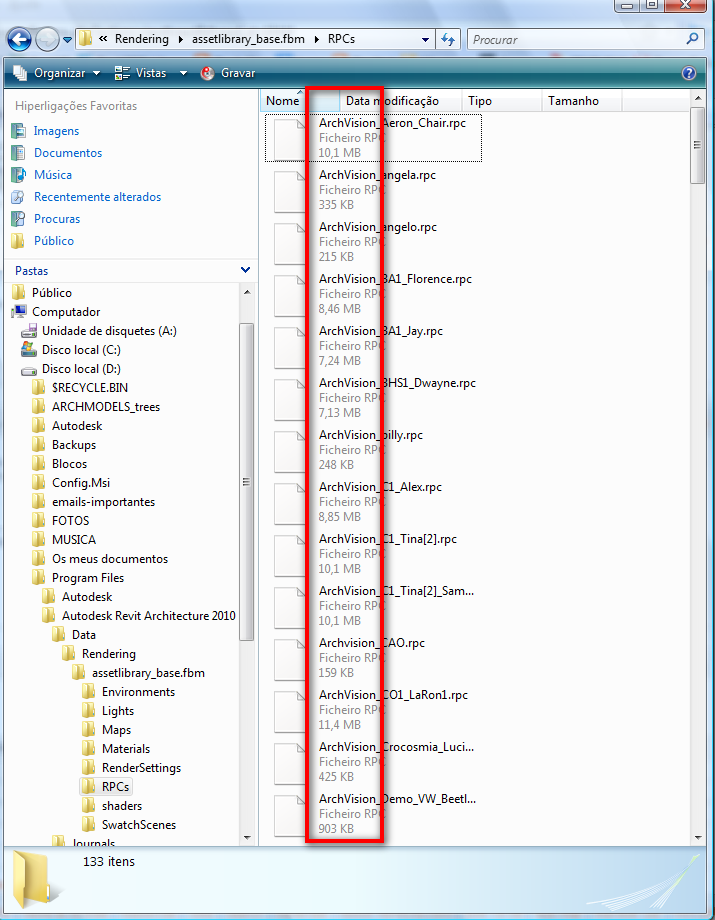

One thing, if you want to use OLD RPC from 2008 and 2009, change the name, START by "Archvision_.RPC like you can see in the image, check if those RPC names start by "ArchVision...."
