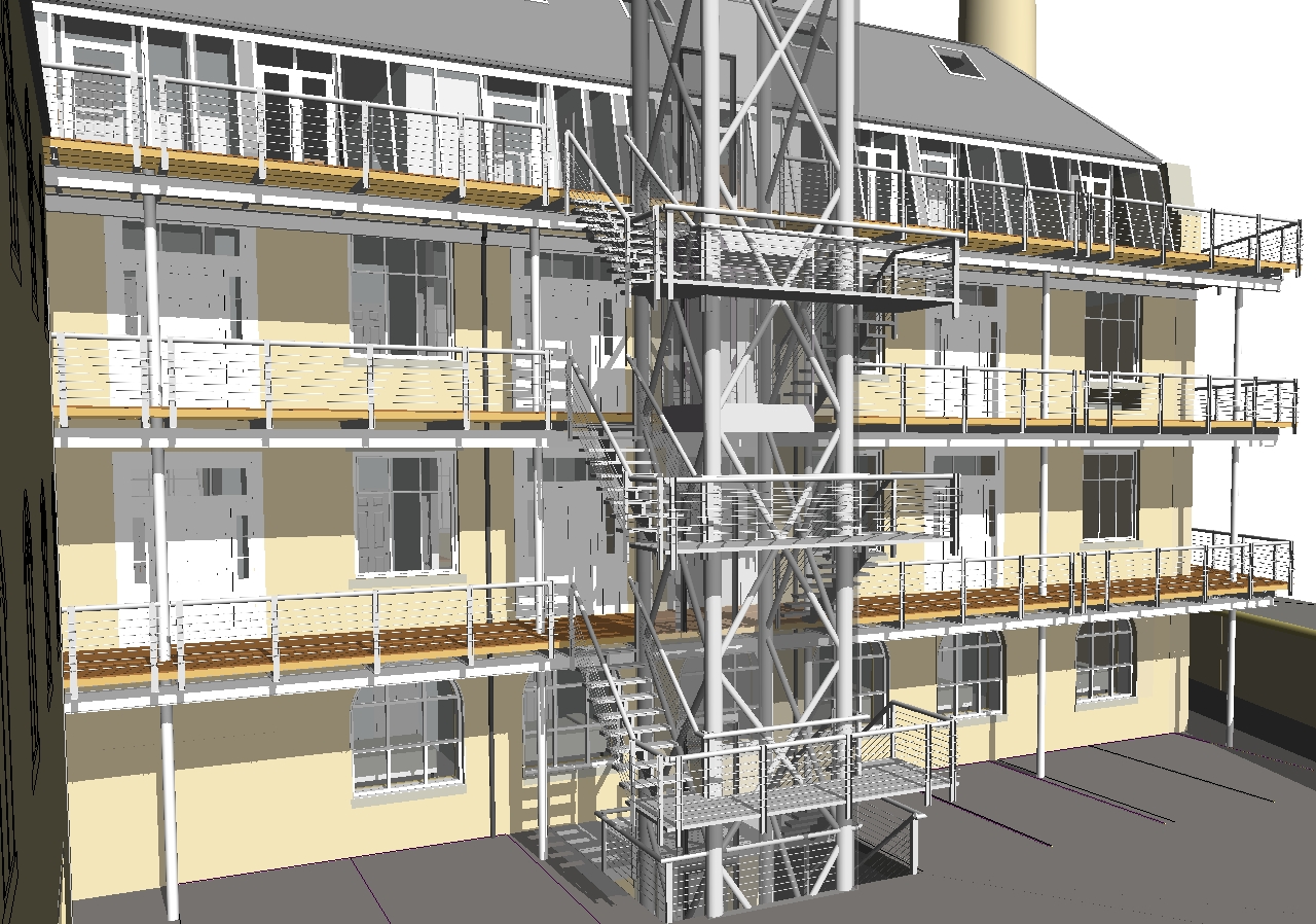

I'm not sure how many people are already doing this, But for those using revit for smaller projects ie:residential work and they would like to show all the wall framing etc. Then try using curtain walls for the framing members, they're easy to move and manipulate, all you need to do would be setup a curtain wall type with empty panels. Then use normal walls for your cladding and use doors and windows whose frames are not constrained to the exterior/interior face of the wall (ie: you can specify the frame depth independently). This would result in an extremely detailed model that would be very easy to manipulate and change. I'm sure there are quite a few people doing this, but for those who haven't tried it, why not give it a go? Cheers.

Sounds like a good tip, I will have to try it when the need arises, thanks for sharing. Do you have any screen shots showing a model with the framing all done? Post edited on 2005-08-26 13:31:08

In the attached screen the extenal lift shaft structure has been formed using curtain walls. Not only the vertical elements, but also the cross bracing is a modified system panel. As Mr. Spot says they are extemely easy to form and contol.
