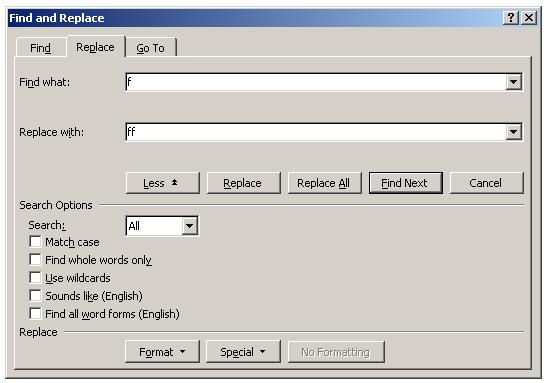

Wouldn't it be nice if there was a find and replace tool for model elements?  Say you place 10 very generic toilets at the begining of a project.  Later you want to go back and replace some of them with toilet A, others with toilet B, and some you want to leave the original.  The tool would be most useful if it had the same options as the MS Word find & replace tool.

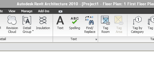

where can i find the find and replace tool in 2010?  i think i'm missing something...

Under the annotate tab - text - right next to the spelling guys.

the only option i have next to spelling is tag by category, meaning my only options in the text section of the annotate tab are text and spelling...is this in one of the updates?

Must have been - see image....

Yeah...it's part of the subscription advantage package

I have a 2010 subscription, but not the Find and Replace as shown in the image. Is there a special package I need to download or sign up for to get it?

The Subscription Advantage Pack for Autodesk Revit Architecture 2010 is available at the Subscription Center. You can access the Subscription Center at http://www.autodesk.com/subscription.

it's not a full version it's a Subscription Advantage Pack.
So when you connect to the Subscription centre don't check under download your software but scroll down tot the product add-on section.
Here you can choose; *Subscription Advantage Pack for Autodesk Revit Architecture 2010, you can down several add-on's here.
