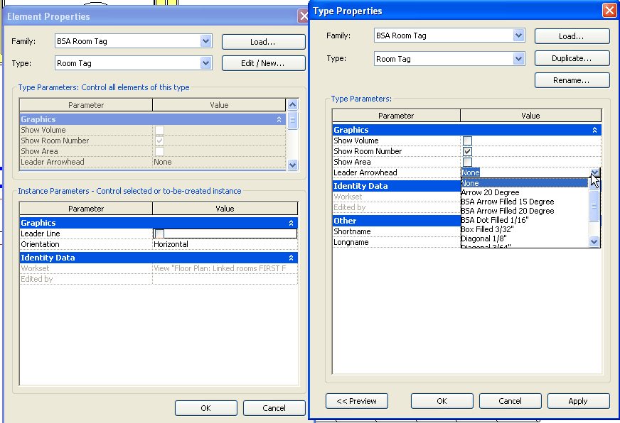

Good day. I'm trying to add arrowheads to my space tags but can't really don't know how to do it. Please help. Thanks!

For both Area and Room tags, the arrowhead is a choice in the type menu.  It is a pulldown and your choices are system level and the same as available with normal text leaders.
To turn the leader on, select the tag and turn on the leader on the options bar.
