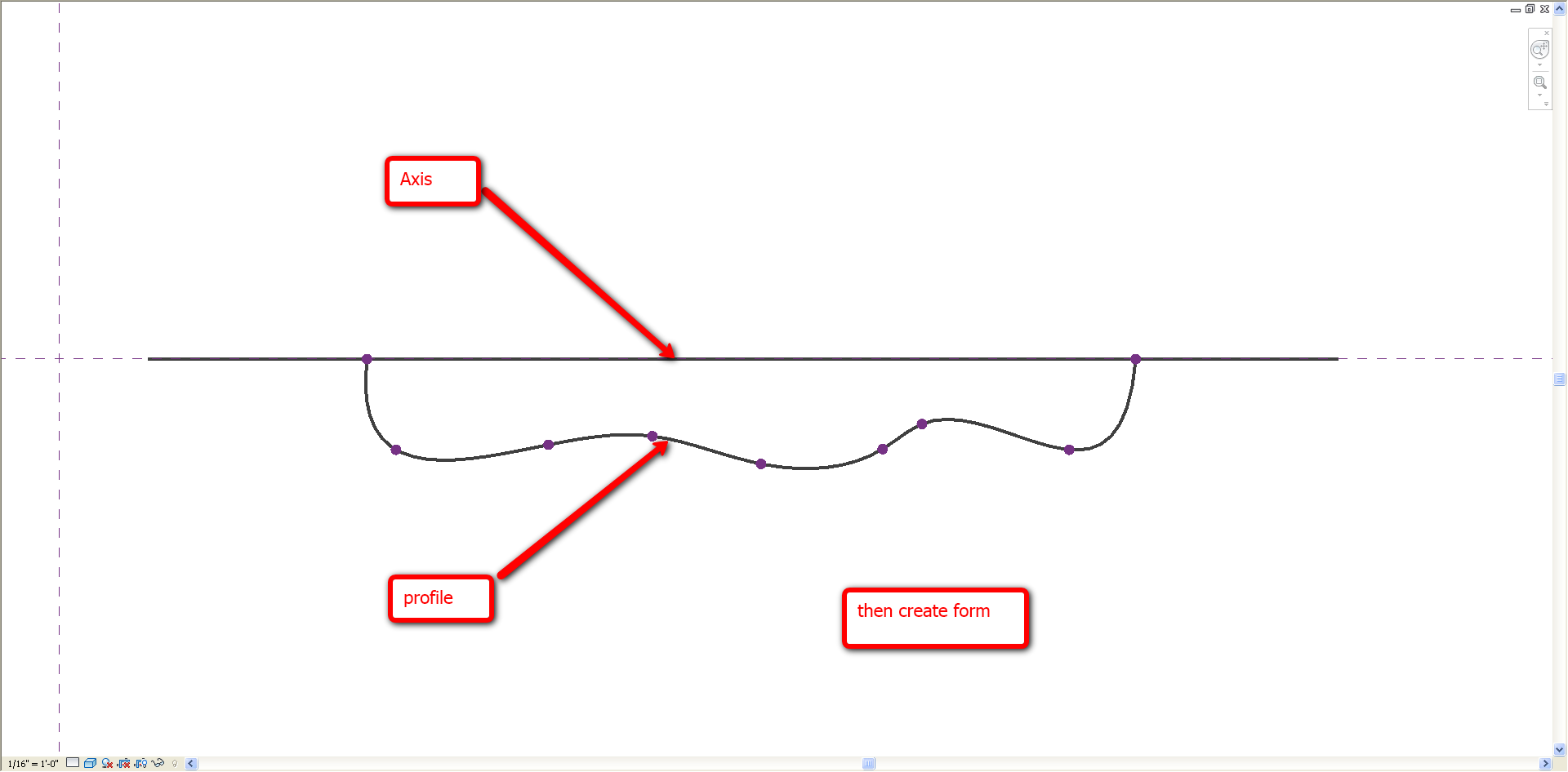

to revolve you just draw your profile and an axis and then create form. pretty simple... the tools are on the main interface.Edited on: Thu, Oct 22, 2009 at 12:18:31 PM

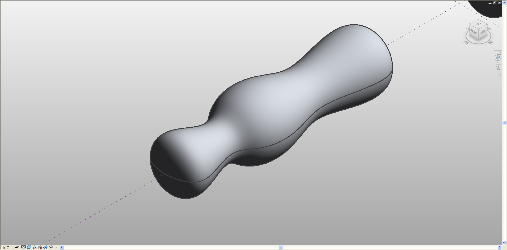

Thu, Oct 22, 2009 at 12:19:27 PM | Revit 2010 Is Driving me MAD !!!Making Mass with FORM tool is ..confusing me!!!!
alabaster2513
alabaster2513 Avatar
Joined: Tue, Jan 16, 2007
1009 Posts
3.5 Stars: 25 Votes
took about 15 seconds to create

the axis of the revolve has to be a seperate entity, sounds like revit is thinking your oultine is a closed loop for extrusion. extent the lines of the axis beyond the revolve profile.
