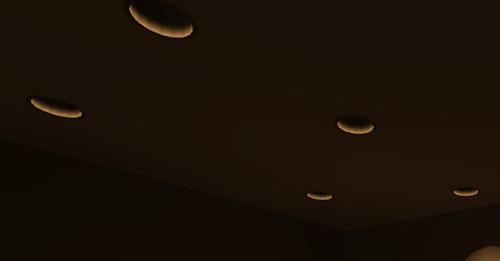

Hey guys Im having the same problem. It says artificial lights:4. but there is probably 25 lights in my view and more outside my view that should still be considered, they are rendering illuminated but they arent giving off any light, ie. the corners that sunlight doesnt reach are black. any suggestions?

So ive done all that typhoon suggested, and still I get no lights..

here is an image. (dont know how to "edit posts" on this site)

after render you have the "Adjust Exposure" where you can play with the values, but first select one of those lights, go to properties, edit type and increase the wattage (lumens).
