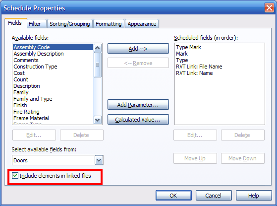

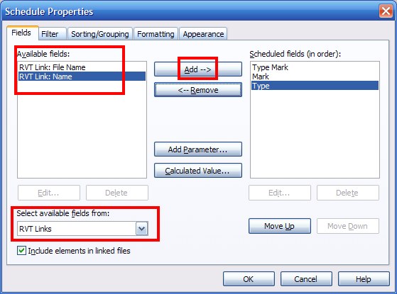

You can link the models into the composite project and schedule the linked objects. Use 'Include Elements in Linked Files'. You can also add to the schedule, the 'revit file name' so each door or window can include a column for BLDG-A, BLDG-B etc. So yes you can get that far.
