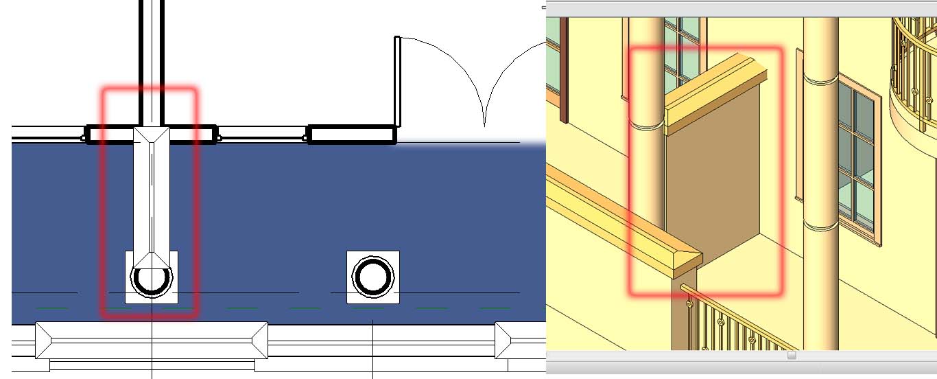

I am a new commer. Why 5'tall balcony separation wall (Wt parapet cap family on top) is
overlapping the cut column and walls? Pleasee see the attached jpg for reference. I am using
R Arch. 2010.

check that your cut plane is not above the parapet.

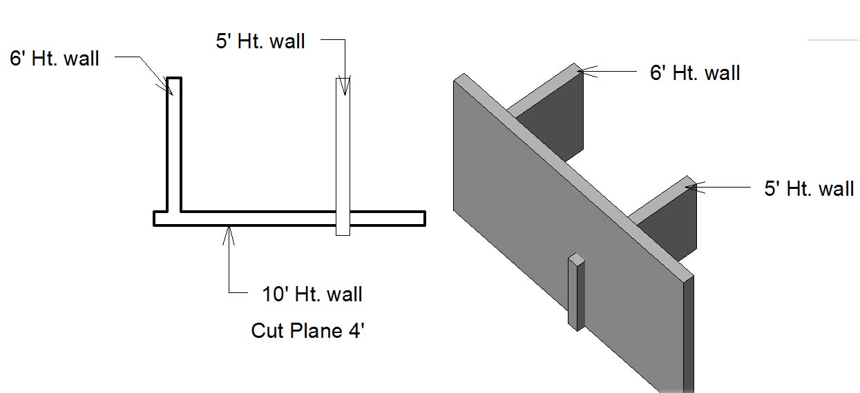

Yes I did. It is 4' above. And I also test that in a  new file, the same problem occures. There are two
problems that I have noticed, firstly if the wall is lower than 6', cut line doesn't show up, secondly, any
shorter wall has overlapping display. It is simillar to display order in CAD. Pls see the attachment.
