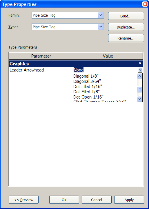

I am currently working on two different projects on Revit.  I set both of these projects up the same.  However one of them I have the option for the Pipe Size tag to have an open dot arrowhead.  The other I do not have that option.  Does anyone know why?
Thanks!!!

Hello!  The leader type is a Type Property of the Pipe Size Tag itself.  To modify the existing Pipe Size Tag that you are currently using, just select one of the Pipe Size Tags in your drawing, right-click, and choose Element Properties.  In the Instance Properties dialog click on the Edit Type... button.  Click in the slot to the right of Leader Arrowhead and choose the arrowhead you need as shown below.  Do this in your project start-up template to assure that your Pipe tags have the open dot arrowhead in the future or copy and paste your customized Pipe Size Tag to a project template.
