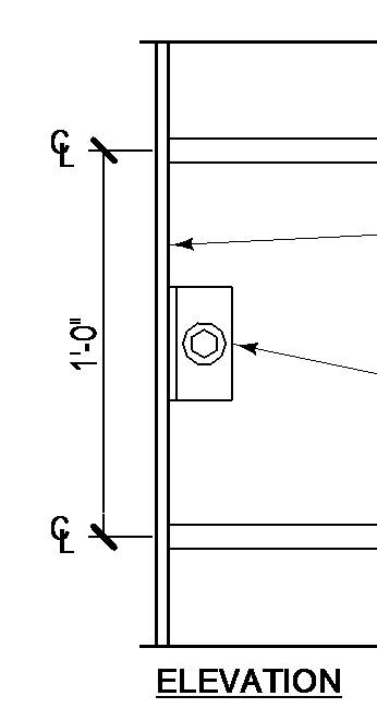

On this topic, I need to draw a dimension down the centerline of some steel pieces, but there's no grip points to attach a dimension to in the center of the structures, so does this mean I'd have to use this white line technique, or is there another way? I included an example of the detail as it looks in AutoCAD
I appreciate the help.

In Revit, we would have a reference plane in the family (bm) that we can dimension to.....
Do you really dimension to the center of the flanges?  What country / standards to you use for that?

We're a firm in the US. While I might be fresh out of college, the last 5 firms I've interned or worked at have done dimensioning like this in some form in at least one detail or drawing. I wouldn't consider this something absolutly insane or off-beat.

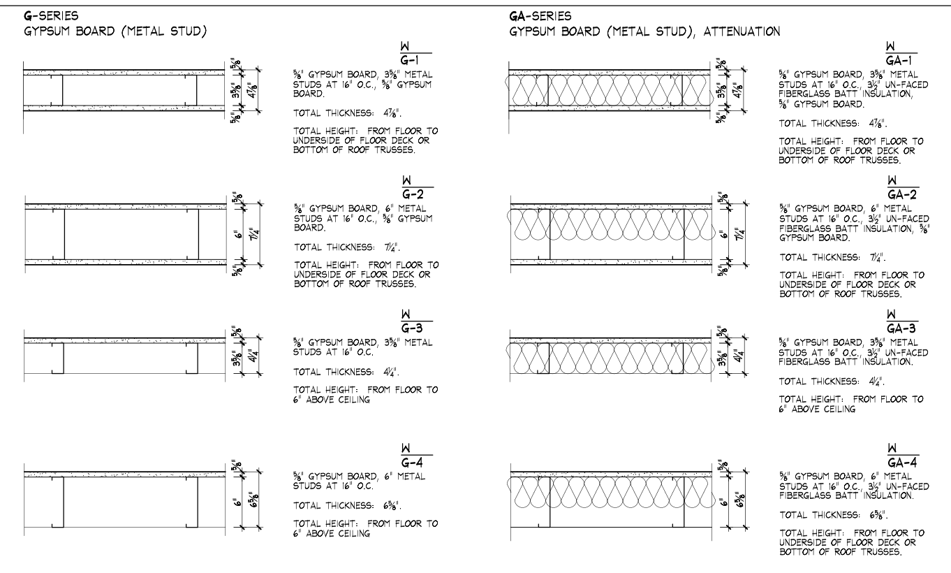

I'm wondering if the new releases of Revit have brought some change to this inability.  The reasoning I have for the need is to create our wall type schedule (attached as photo).  Do I have to create this as a detail, with basic lines, rather than a legend that contains the literal wall type inserted?

We use legend components but we add small yick lines for dimensioning.
