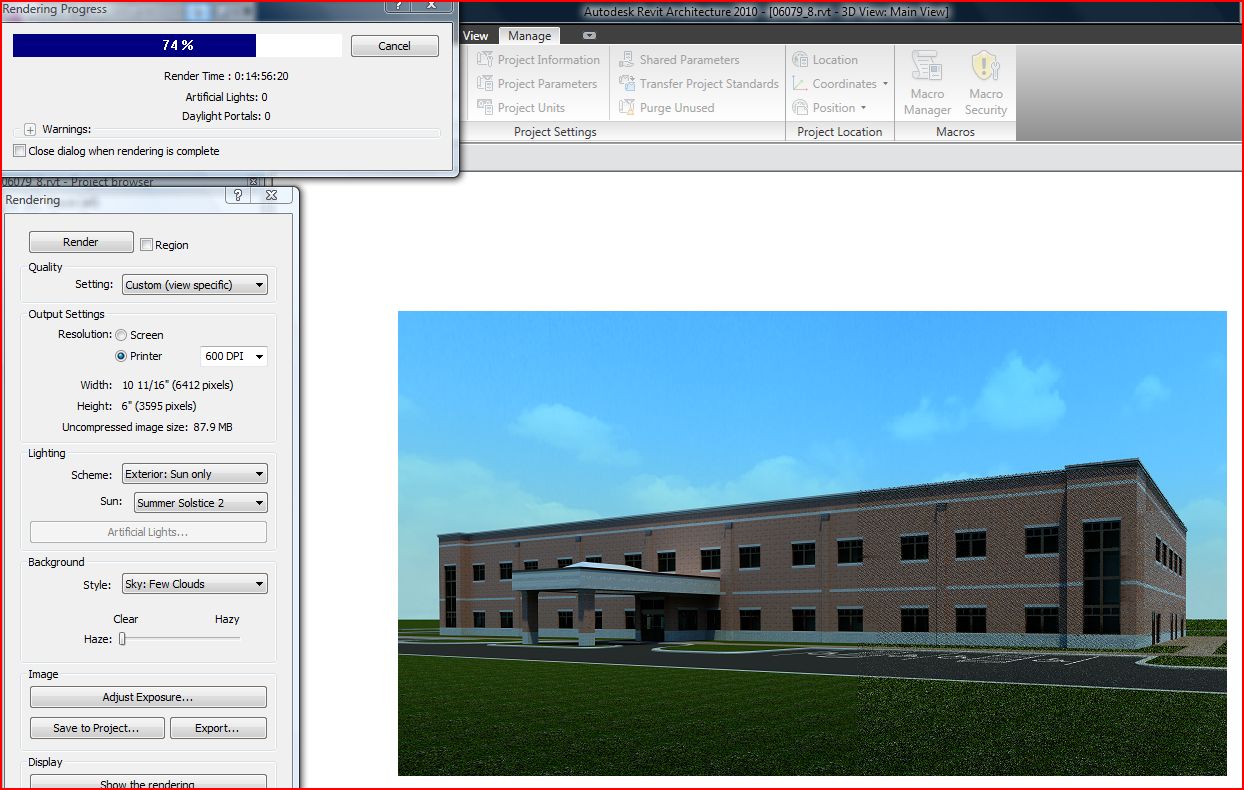

Is it just me or did render times slow with service pack 2?  I am doing an exterior render 6" x 10" 600 dpi and it has been running for 15 hours and is only at 74%??  I don't even have any trees or entourage in it.  It would fly through a scene like this over night before.

In your image you change the "Settings" to "Custom", it's in High? Best? did you change some custom parameters? if you increase Anti-aliasing or the other parameters you gonna increase also the time of the render...

Typhoon....I copied "medium" to custom and pushed anti-a to "8" which is pretty typical when I have lots of texture maps
 I am shooting to put this on 11 x 17, so I was going just under that and hitting 600 dpi, so I can double the size of the image without losing too much.  Any suggestions?

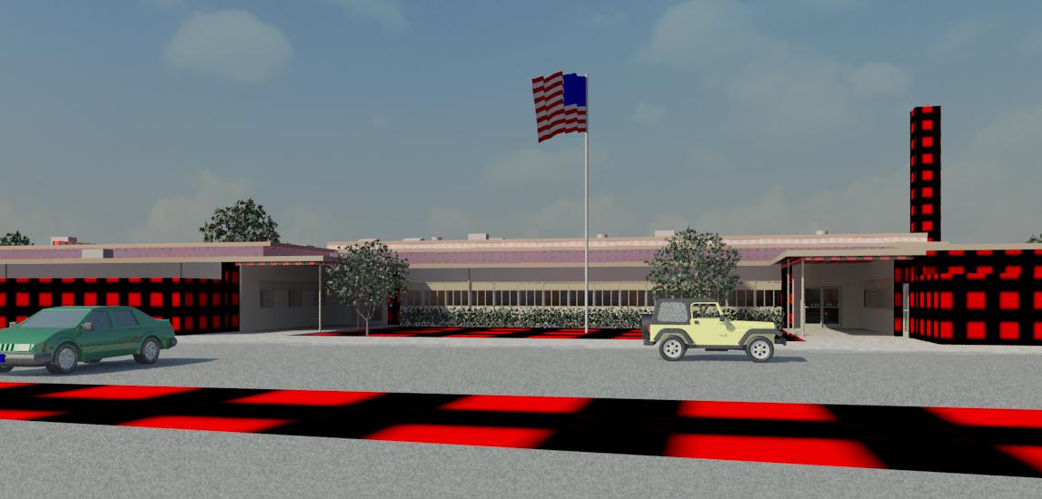

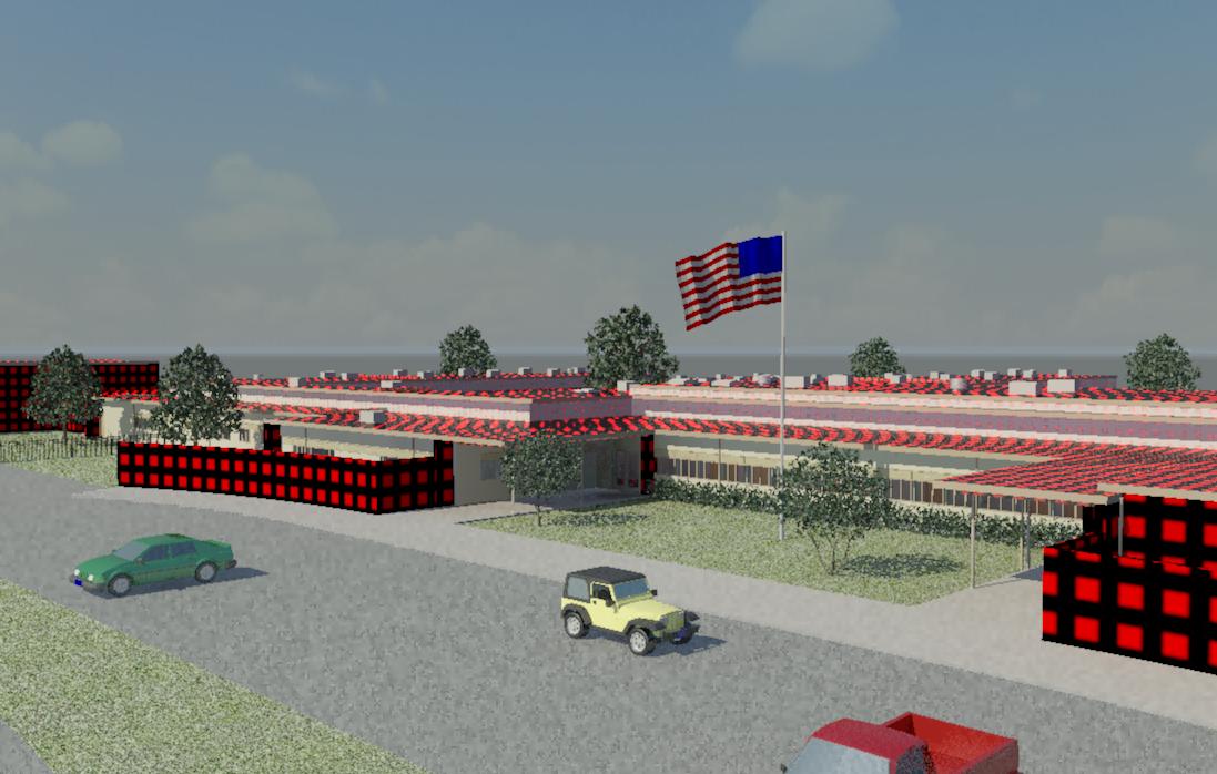

They partially broke the Rendering engine in 2010. I some of my 3d views I get random texture swaping to a strange black and red pattern.

WOW, Hardware Acceleration where have you been all my life!!  It is rocking out the render now that I have it on.  Sooo much better.

Wolf, don't tell me you didn't had the hardware acceleration on (directx)?

nope Typhoon, I didn't...until now!!  Don't think I'll ever render without it HA again
